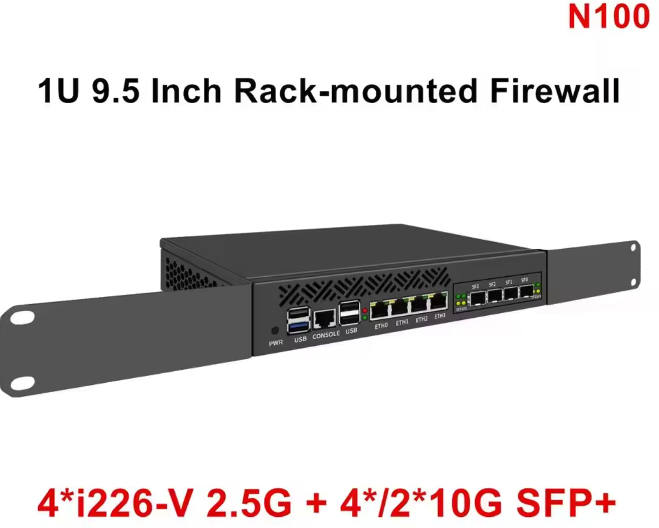

@Louie1961 @xMAXIMUSx how about something like this:
It just doesn’t have a dual drive…
can’t seem to find many of those (<$200) plus, I’m in EU so shipping would be another 100 or so…

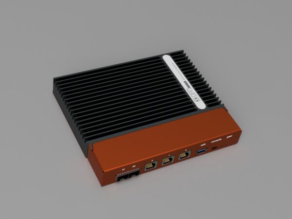

Here is 1 premade firewall that will fit on a 1u shelf and have SFP+ ports:
You could then (probably) install your OS of choice. The 2752 and 2770 would be better for installing in a rack, but more money. I’m sure Netgate has similar products in similar price ranges.
