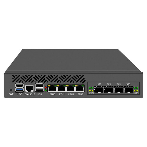

this looks like a really nice option, but it has the IO in the back, right?
Yes, but I think Supermicro has some purpose-built devices that has the port at the front.
LINK or LINK
Something like this, maybe from the older generation or without the motherboard.
You should look for SYS-50XX-F (50 is the cheaper, compact series, F is from facing)
https://www.aliexpress.com/item/1005008552929120.html
Super device
exactly!
I see 2 downsides:
  • no dual disk
  • hard (to impossible) to expand in the future…

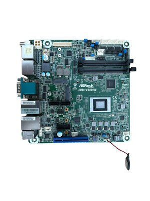

I will bring up this one again for two reasons. You mentioned not being able to find it on ebay:
Also, I was having some difficulty with the realtek NICs on this board and the BSD kernel. I tried both OPNsense and pfSense, and would have random drops. I have since decided to run Proxmox on this and it has made an absolute world of difference. I loaded up the actual Realtek driver using the DKMS process and it works perfectly. Rock solid. Also, I have virtualized pfSense in Proxmox and it is running much cooler. The CPU on this board is a 8 core/16 thread CPU, and the board does support ECC memory. So I have given pfSense six cores (a bit of overkill, but whatever) and it runs great even with pfblockerNG and Suricata enabled. In Proxmox, I have to LXC containers running: one with cloudflared for my Cloudflare tunnels and one for Crowdsec. I also have a Debian 13 VM set up as a docker host, and I am running Pi Hole, Uptime Kuma, Librespeed, Nginx Proxy manager, Vaultwarden and Watchtower in docker containers. I have turned this into a sort of “edge” server for my homelab, and put everything that I think would benefit from being on the same host as pfSense onto this device. I have to say I am super happy with the setup. I am sure you could put this board into a 1U chassis, but you will likely need a better cpu cooler than the one it comes with as well as you will need to ensure good airflow in a 1U case. Even with the shipping from Los Angeles, I bet you can stay within your $300-$400 budget.
