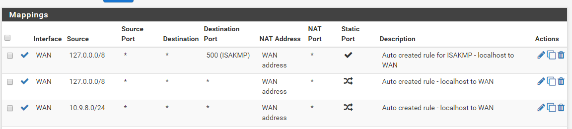

This has been edited to reflect Copy 2nd from TOP
Add a mapping (Copy your 2nd from TOP) and change the IP to 10.9.8.0/24 under Source. It appears your 10-net range on OPT1 does not have a mapping to get out to the WAN. You do not need a 500(ISAKMP) entry.
Second from bottom under automatic mappings?
Like this?
yes, if that doesn’t work Im not sure what it is. Could be the card or some other config within pfSense.
