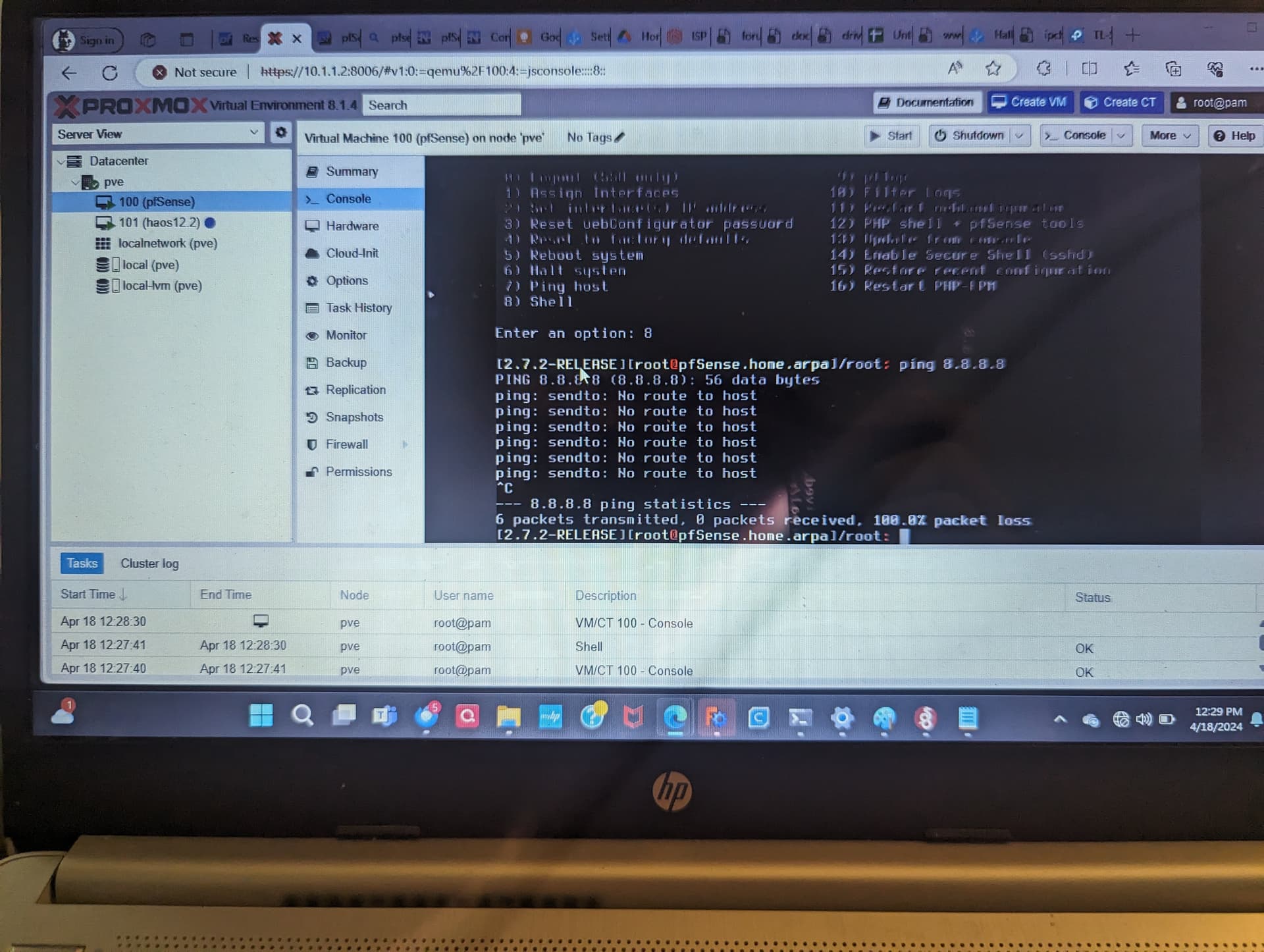

I’ve changed the WAN setting in pfSense to use DHCP. But it’s not getting an IP address. pfSense is running in a VM on Proxmox. Here is a screenshot of the console for this VM. The WAN address is blank. I even tried setting it to STATIC and used what my current address – the IP address was listed here, but I still had no internet connection.

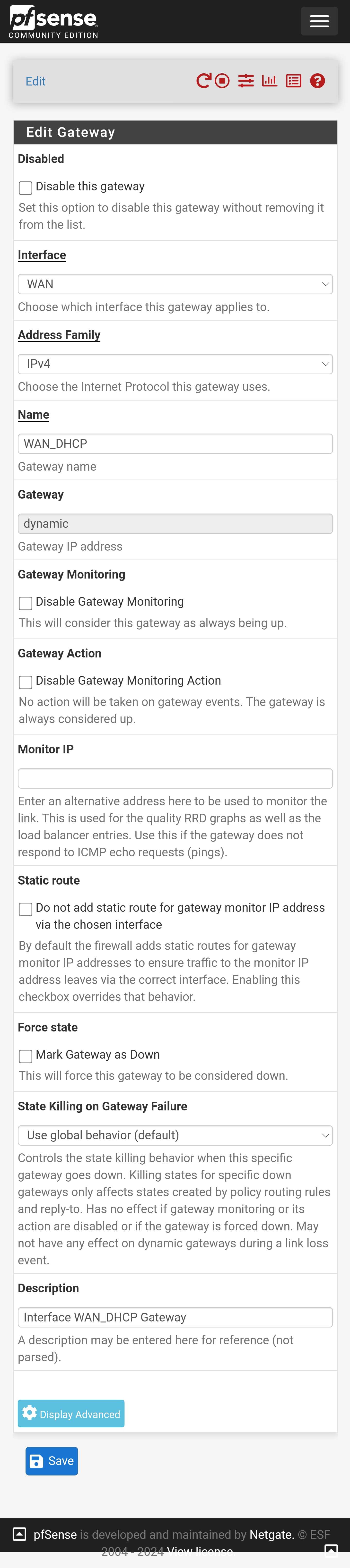

I set the Gateway as disabled and tried to create a new one. But I didn’t know what to put in for the “gateway address”. Prior to activating bridge mode, the gateway was 192.168.1.1 (the LAN side address of the ISP Router) and pfSense’s WAN was set to 192.168.1.2.

I went back and created a new gateway that uses DHCP.
If your WAN IP is 169.253.60.71, your gateway probably is 169.253.60.1 (unless they service a bigger block that 256.) That should come from your ISP.
My WAN is A.B.73.9 but my GW is A.B.72.1
Pfsense > Status > Gateways show show it.

Ping 8.8.8.8 No route to host.
