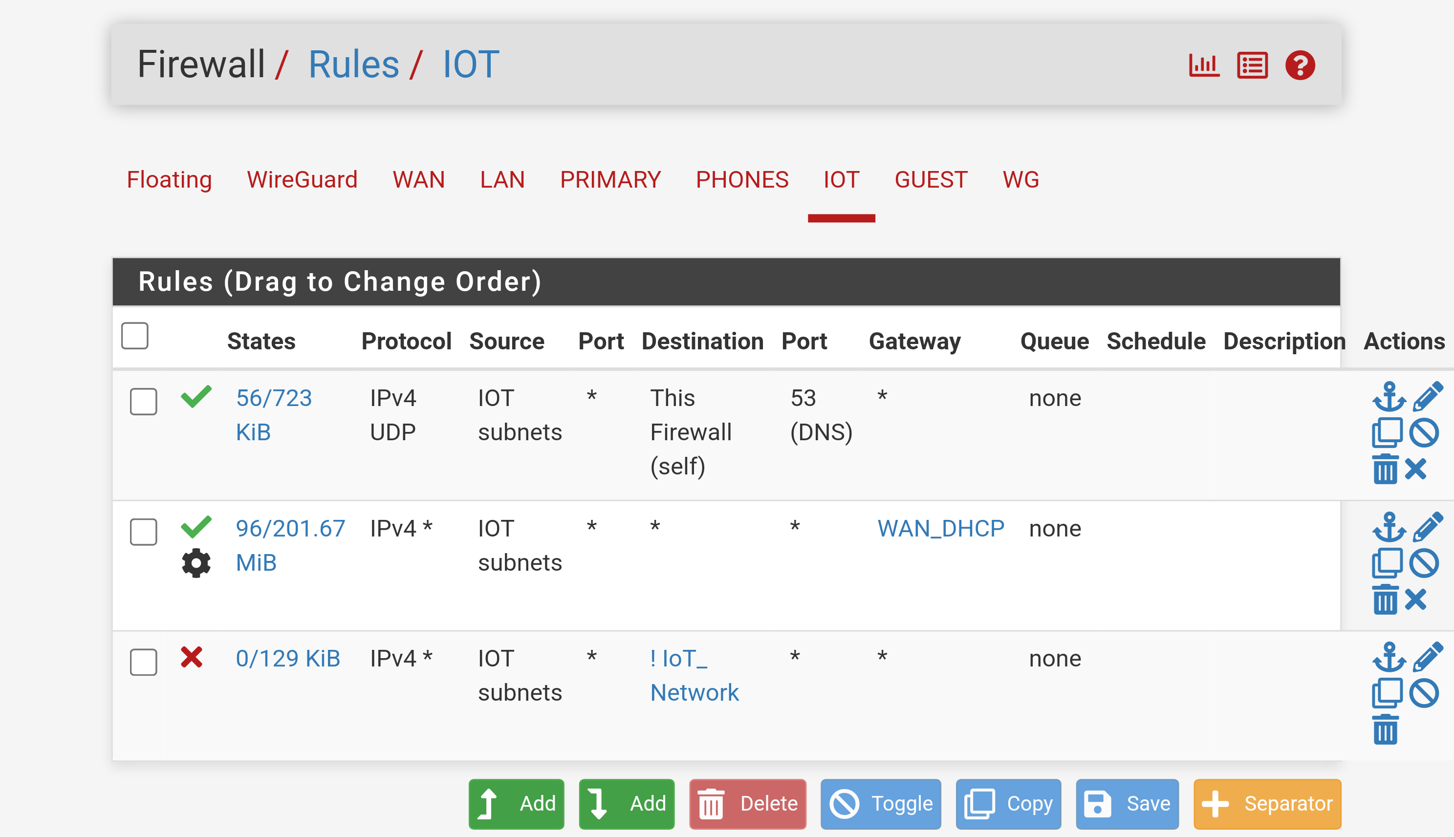

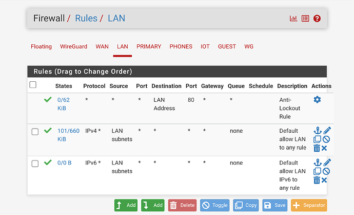

Here’s what my FW Rules look like.
If you can ping 8.8.8.8, from the IOT network, then you have at least basic internet connectivity. If websites fail, the next likely culprit is the DNS server (probably residing in the pfsense VM).

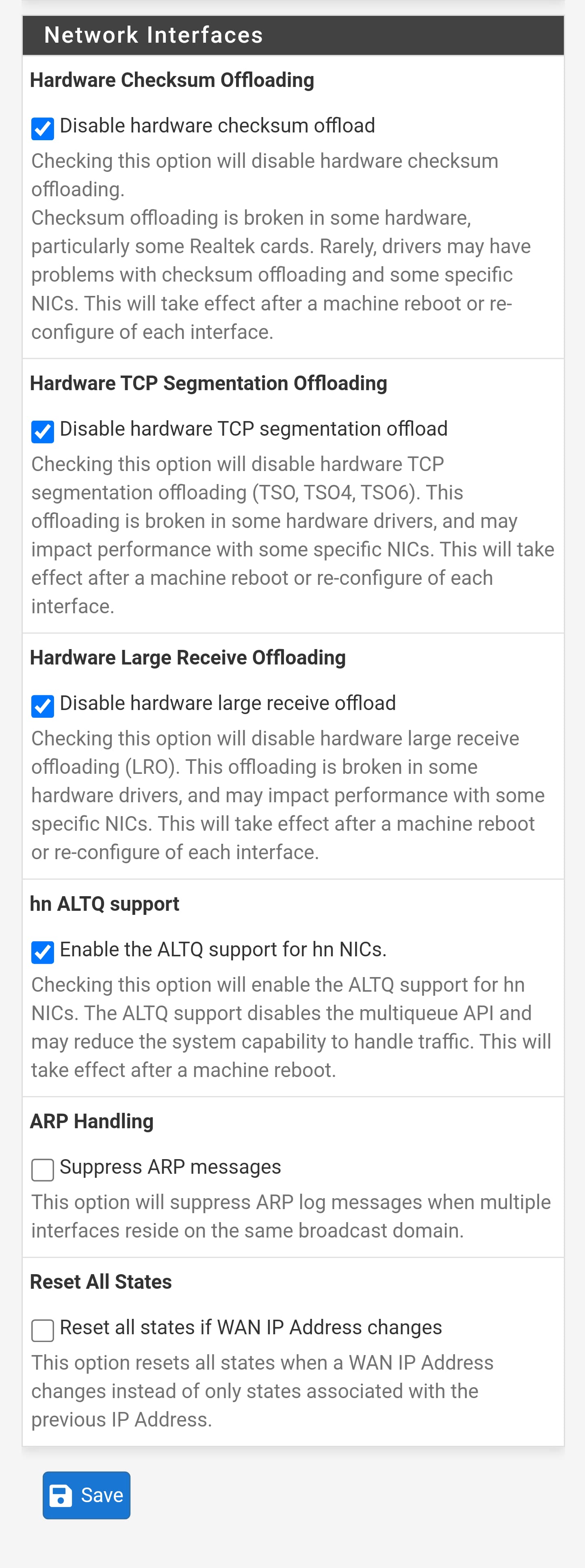

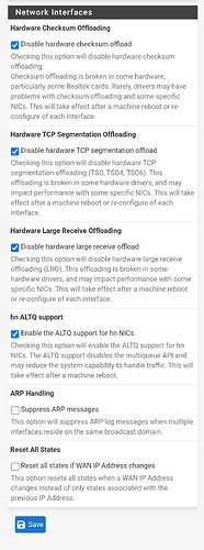

Just to be sure, under the pfsense web interface, in system → advanced → networking
and under the ‘Network Interfaces’ heading:
You have “Disable hardware checksum offload” , “Disable hardware TCP segmentation offload”, and “Disable hardware large receive offload” all are checked?
I believe the answer is yes across the board.
