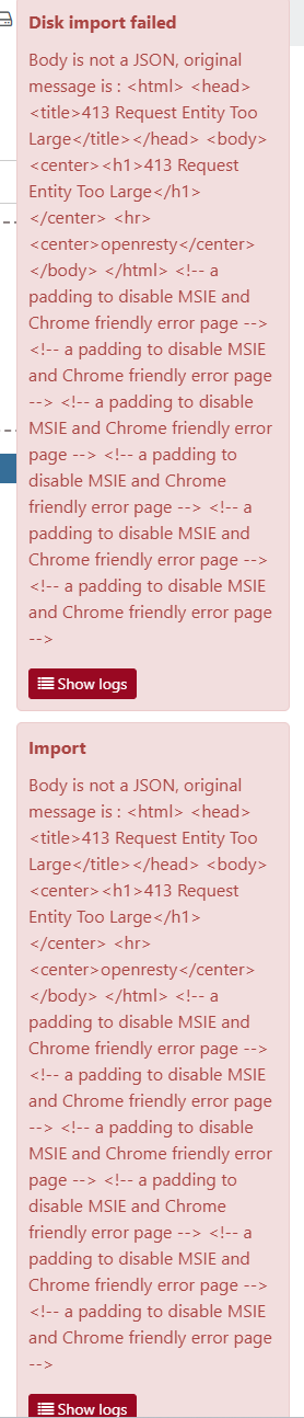

So i ran into a problem that i dont know if always exited or just started. The issue when i try to upload and ISO file to my Xen Orchestra built from sources i get an error message.
If i do the same but access XO from its ip vs fqdn it works. I posted over on the xcp-ng form Disk import failed | XCP-ng and XO forum and Oliver suggest i increase the max upload size in nginx.

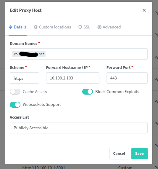

This is probably due to websockets. Do you have that enabled on NPM?
yes.
My fault. I don’t know what I was thinking. This occurs when the server receives a request that exceeds the configured maximum size limit. Meaning you need to update the client_max_body_size to something larger.

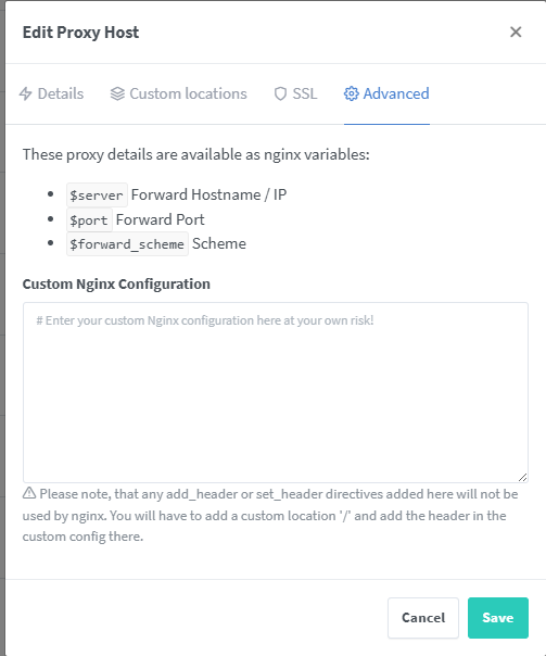

You would put this in the advanced section. If you set it to 0 it will disable it and the error should go away
client_max_body_size 0;
Make sure to restart NPM for the setting to take effect.
That did the trick. Just added to advanced tab and it just work. No restart was needed… So question anyone else having this problem. I thought i have uploaded and ISO previously vis fqdn with no issues. Unless i am mistaken and i uploaded them other ways for other reasons…
