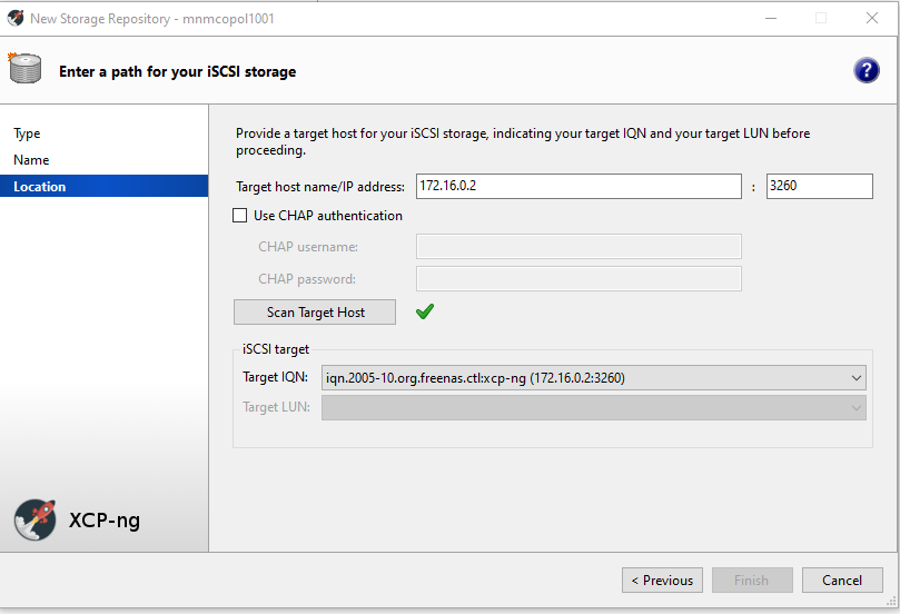

I’m migrating my current connections from 1gb ethernet to 10gb fiber. I removed the exiting 1gb SR and when I try to add the 10gb SR it sees the Target IQN but the Target LUN is greyed out.
Note: XCP-NG Center is EoL.
Well it was EOL, then someone just announced they are going to work on it, but as far as I know that is just one maintainer.
