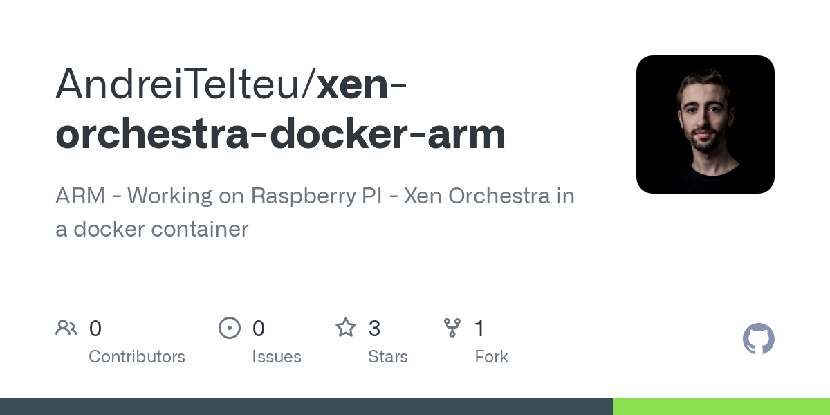

Was just looking on Google and came across this thread. I do actually have XO on ARM working again, it’s in the linked repository. This does include backups, VM management (console, stats), everything as far as I can tell.
