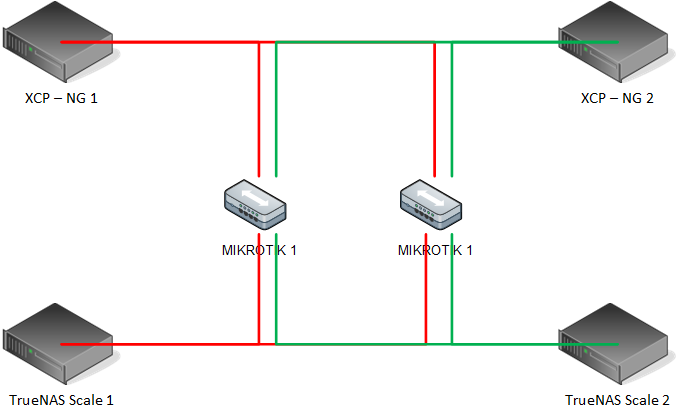

Hi to everyone. I have the two DELL R7610 with 2xE5-2670, 128 GB RAM, 2 x 200GB SSD and 4x600GB 10k HDD’s, and dual 10Gbe NIC’s (fibre optic), Also I have available 2 Fujitsu Primergy RX300 S5 with 2xX5504, with 64 GB RAM, 8x600GB 10k HDD’s and also Dual 10 Gbe NIC’s. (fibre optic). Also I can have 2 MikroTik CRS305-1G-4S+IN optical switches for connections. I was thinking setting up the DELL’s as XCP-NG Hypervisors and the RX300’s with TrueNAS Scale for Storage. Would these be enough to setup a HA setup or at least something resembling that? Both sets of machines (1 DELL, 1 RX300, 1 Mikrotik) will be in two different buildings with 4 fibre optic connections available.
Is it doable and if yes is there a bit of documentation to see how to do it? I was thinking a scheme like this:
HA XCP
Is it viable?
Any help will be much appreciated.
Thank you in advance

  1. Are you planning on the truenas scale deployments to be in HA? Or are you using them as 2 separate iscsi/NFS targets?
  2. If this is going to be in 2 different buildings is this still the same local network or is this a different site altogether?
I was thinking on having them as NFS targets. Although we are talking for two different building it’s only one Local Area Network. I have available 6 direct connections with Fibre optic between the two buildings. So I thought I would use 2 of those direct connections on each side. So every one of the servers has two F.O NIC’s So XCP-NG 1 will be connected with MICROTIK 1 and MICROTIK 2 the same for all the others. Those 4 servers and 2 switches will make their own lan for syncing purposes only. Then they will be connected to the rest of the lan with CAT 6 to the Main LAN switches. The main lan switches between the two buildings also have a direct Fibre optic connection.
