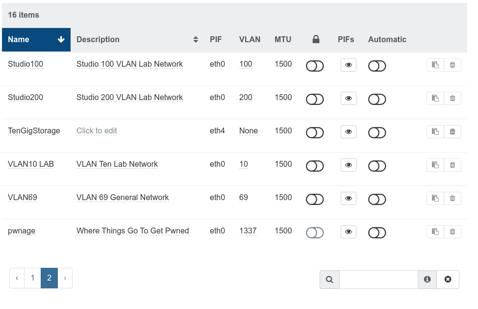

As shared in my screenshots, I am using the ā€œMultiple VIFsā€ approach. I don’t needs more that 7 and I have not any client situations that needed more than 7 either.

I followed the instructions and set my ports to ā€˜trunk’ mode with no DHCP as all server get static ip assign to them.
Inside the VMs I set the interface ip to 10.10.12.20 with gateway of 10.10.12.1 but none of my VMs can ping each other…
I’m pfsense, I created vlan10 on my lan interface. Do I need and firewall rule set for it to work? Do I need to delete the gre network I created?

I deleted all the private network and created a simple vlan network as per @LTS_Tom screenshot above.
When both VMs are on the same host they can ping each other with no problem but when they move to another host in the same pool, then, the ping stop.
Some switches require the VLANS be defined in order for them to pass the traffic.
100% correct… After adding the vlan to the switch, everything is working.
