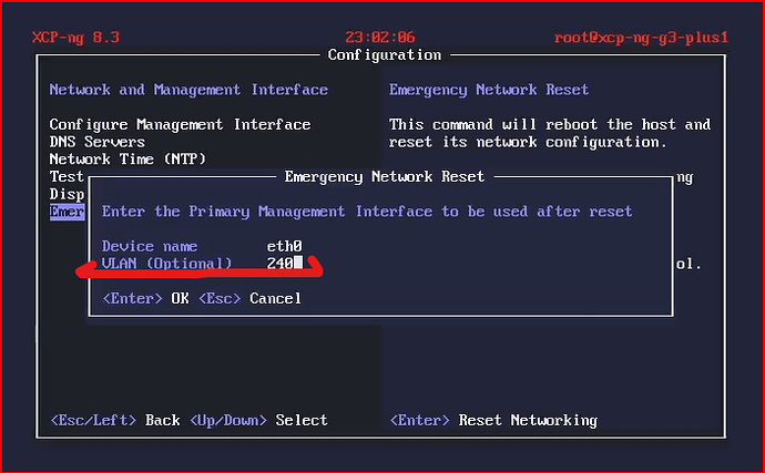

tl;dr - how to specify which VLAN in XCP-ng host to use for management interface using a single shared LAN NIC.
This screenshot or reference:
This might be completely wrong, and I know “by right” a management interface should be on it’s own physical interface on it’s own VLAN, but what about “servers” with only 1 physical LAN interface?

When I try set “VLAN (Optional)” to 240 as per the picture, it doesn’t get an IP address at all. If I switch Port 18 to be native VLAN 240 it of course gets an IP as expected.

Well, thinking on it, why is “VLAN (Optional)” even there? I set it to 240 and it doesn’t connect to VLAN 240 - whether the port is set to native 240 or trunked.
If you set the management VLAN to “empty” on XCP-ng then you need to connect the XCP-ng interface to a switch port where the management VLAN 240 is “native”.
In the other case you have the management VLAN (e.g. 240) as one of the of VLANs assigned to the switch port (and native turned off) connected to the Xcp-ng interface. In that case you need to set the management VLAN to 240 on XCP-ng.

Ya, how you describe (1) is how I have it running since, and it works fine that way. When I tried (2), it would not get an IP at all, with VLAN 240 tagged, but I didn’t have natve=off because I had native set as another VLAN at the time. Maybe if native was off it might have worked. I’ll try it some other time.
I don’t think that this would make a difference regarding DHCP. Did you ensure that the DHCP server service is running on the VLAN 240 network and handing out an IP?
