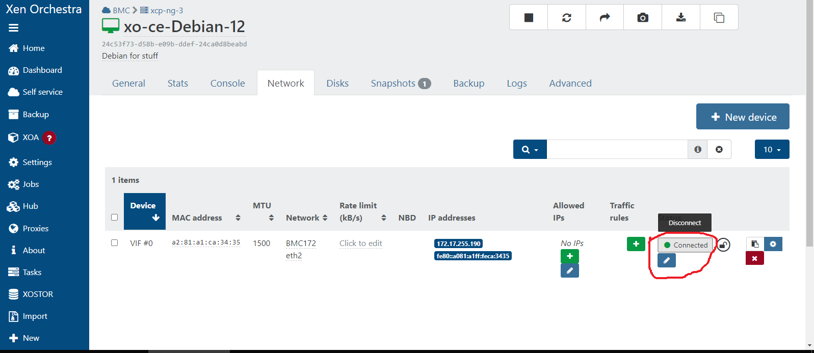

In XO, can’t you just click on the network to disconnect it? No settings in the VM should change, just that the network cable should be “unplugged”. Is this what you want?
Seems to work the way I describe above when I click it to change modes, you can lock it if you want to make sure it can not come back up.

The connect/disconnect can’t be set while the VM is off, only when the VM is running, which in my case is to late.

VIF Plug and unplug seem to be the only thing that might apply, and not sure it will hold during power off to power on state. [edit] says VIF unplug only works on running VM, so not an option here.
