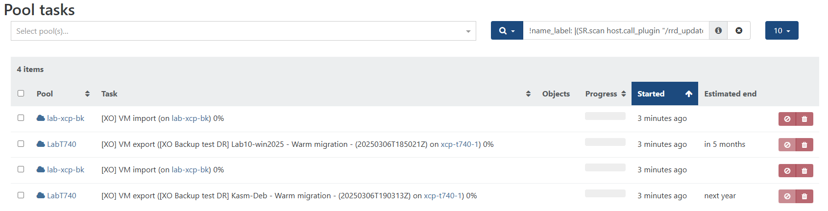

I’m going through and planning out a better backup and DR plan, and remembered something while thinking about the health checks. When doing a health check, does the process time out after XX minutes?
Yes I know, you are thinking that the management agent should be up pretty quickly, but there’s a wrench in the Server 2025 gears.
When running Server 2025, and running Active Directory (and maybe other modules), there is something that prevents the management agent from starting. After some fooling around I found that the simple answer was to go to services → select the MA service and stop it → then double click and set the service to automatic (delayed start). Best to then restart the VM to reload everything. Now the system will boot, and it takes “a long time” for the MA to start, could be 1 minute, could be longer, never really timed it on the single 2025 VM that I have in my lab.
So does the health check time out if the MA takes too long to start?
