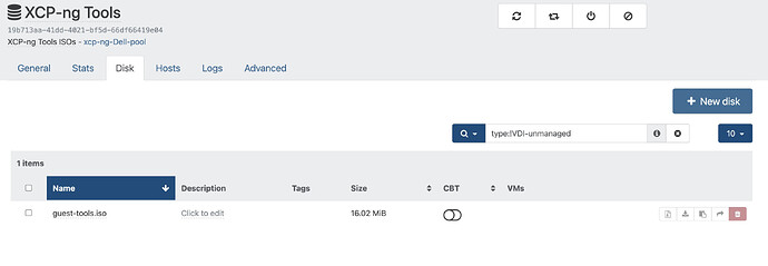

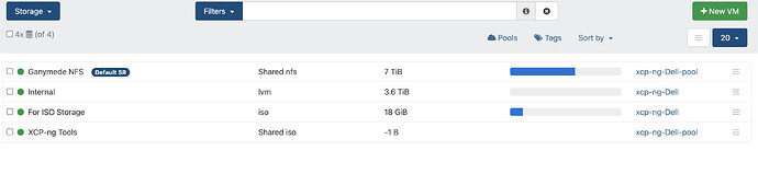

Not sure if this is a clue, the Storage pool shows -1B for the tools I loaded via Tom’s Youtube video Releases · xen-project / Xen Guest Agent · GitLab , even though the disk itself is 16Mib
That shared ISO always shows as -1 B, at least on mine it always shows this value.
