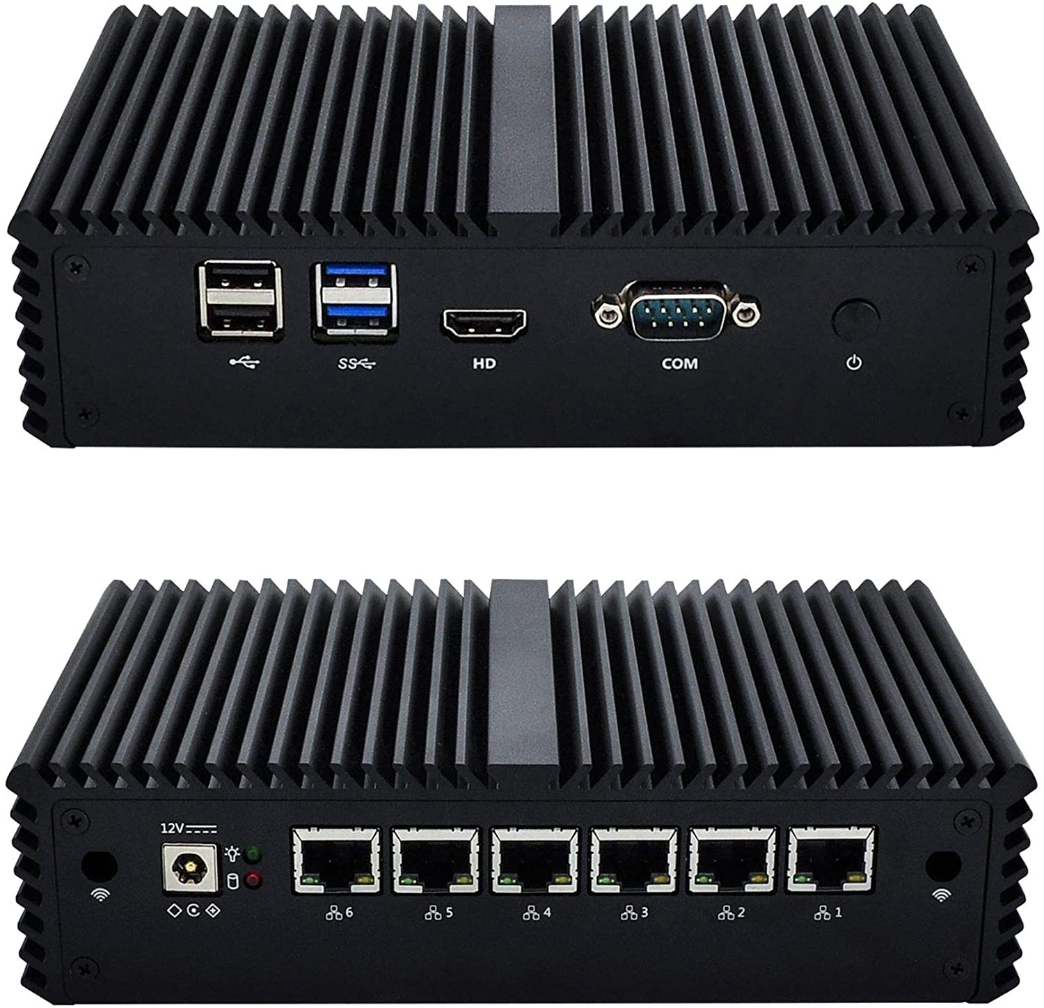

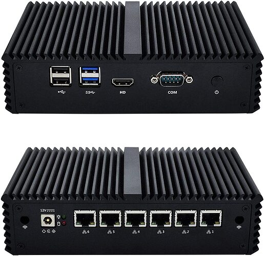

Thank you for the additional feedback. @Spectre, do you happen to know if the Protecli products offer the ability to offload hardware? Is it something pfSense can program? I’ve been looking at them, as well as Qotom and some other generic ones on Amazon. So far, Protecli sounds like the most value, unless I get one of the Netgate routers.
Reading about hardware offloading, it sounds like a nice feature, but not sure if Protecli products come w/, “Smart NICs,” which is what I read are the ones best to offload hardware to when it comes to network throughput.
