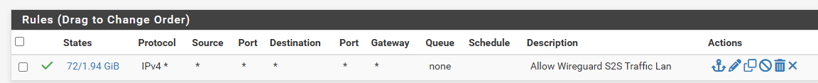

  2. The firewall for the wireguard vpn, needs to be fully open
At both sites the firewall rules for the site to site wireguard should be fully open
