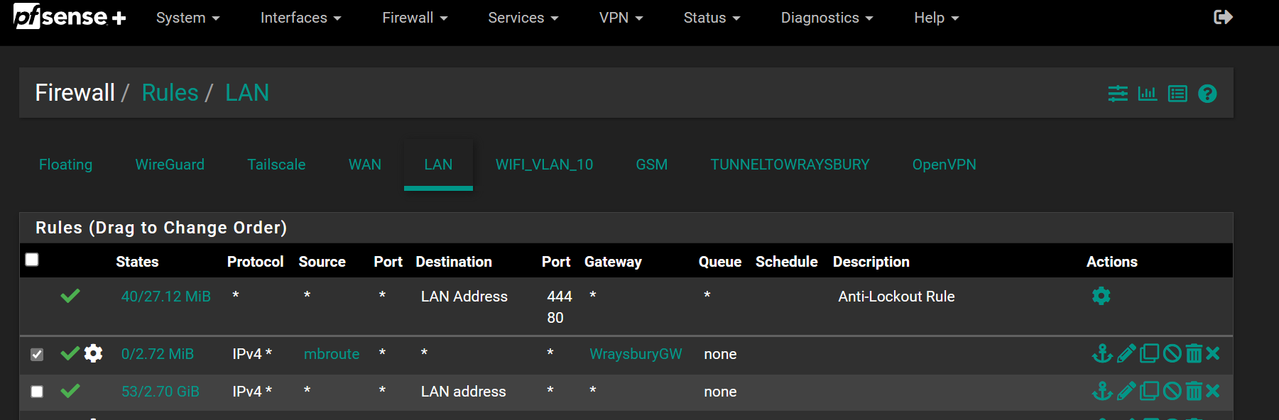

I had a little firewall rule that routed the IP from my TV in France to my home (England) network and out the pfsense firewall there (so I could watch UK IP TV like discovery, disney etc).
I thought it would be simple to just point the existing rule at the new gateway and it would work…
Alas it is not the case. I turned on Firewall logging for the rule and I can see the firewall in France passes traffic out - so I checked out the states and I get lots of CLOSED:SYN_SENT

mbroute is an alias - basically some IPs I want to route and WraysburyGW is my gateway to England which works great.
I have my static route setup along with my Gateway under routing and that all works perfectly when I use an IP address in England form France.
No joy with Internet though.
