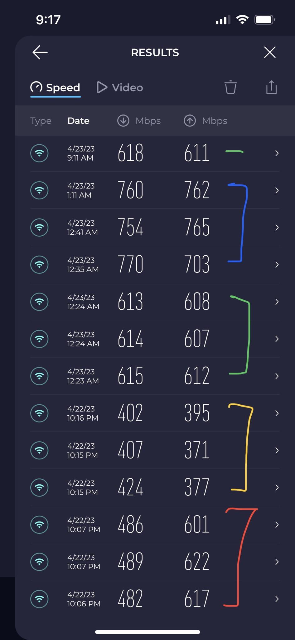

Just an update. I did a bunch of testing yesterday. Omada AP (EAP653) is 2 feet away with no other device connected to the network. Test server used is the nearest one and offered by my provider. It has been consistent.
Red - pfSense Plus 23.01 without traffic shaping/limiters
Yellow - pfSense Plus 23.01 with traffic shaping/limiters (650 up/down fq_codel limits)
Green - Untangle 16.6.2 with traffic shaping/limiters (650 up/down fq_codel limits)
Blue - Untangle 16.6.2 without traffic shaping/limiters
For the yellow results, jitter for both download and upload is less than 10 ms. But when speeds hit more than 600 in any of the results, jitter increases to ~15 ms, both for pfSense and Untangle.
The results are compelling. I’ve always thought that getting 500 Mbps over WiFi was the best my AP could do. It seems like the combination of my hardware appliance (Qotom N5105, 8GB RAM, 128 GB M.2 SSD, 4-port Intel I225-V(3)) and my Omada hardware gives slower WiFi when using pfSense. Could it be because Omada also runs in Linux?

I would remove the hardware checksums in pfsense and see if that make an improvement.
The AP should have no bearing on the firewall, if the AP is able to pass 700mbps, then it should pass 700mbps.
It still seems like a driver issue with the i225/i226 NIC. Does the latest version fix this or do you still need to install updated drivers for this NIC with BSD?
I’d still want to see what kind of speed you get from a wired port, especially from the same port the AP is connected, you could have a bad port or bad cable.

I also tested using different AP unit (same brand and model EAP653) and using a different port in the PoE switch, I get the same results as the I previously posted. It’s the consistent difference in the test results between Untangle and pfSense (single AP, single client) that I want to understand.
It must really boil down to this, i.e. the difference in drivers. I don’t think it’s an issue with the i225 as I’m getting 2.35 Gbps in iperf tests. I wasn’t even aware there was an issue, I just assumed it’s already fixed in 23.01.
