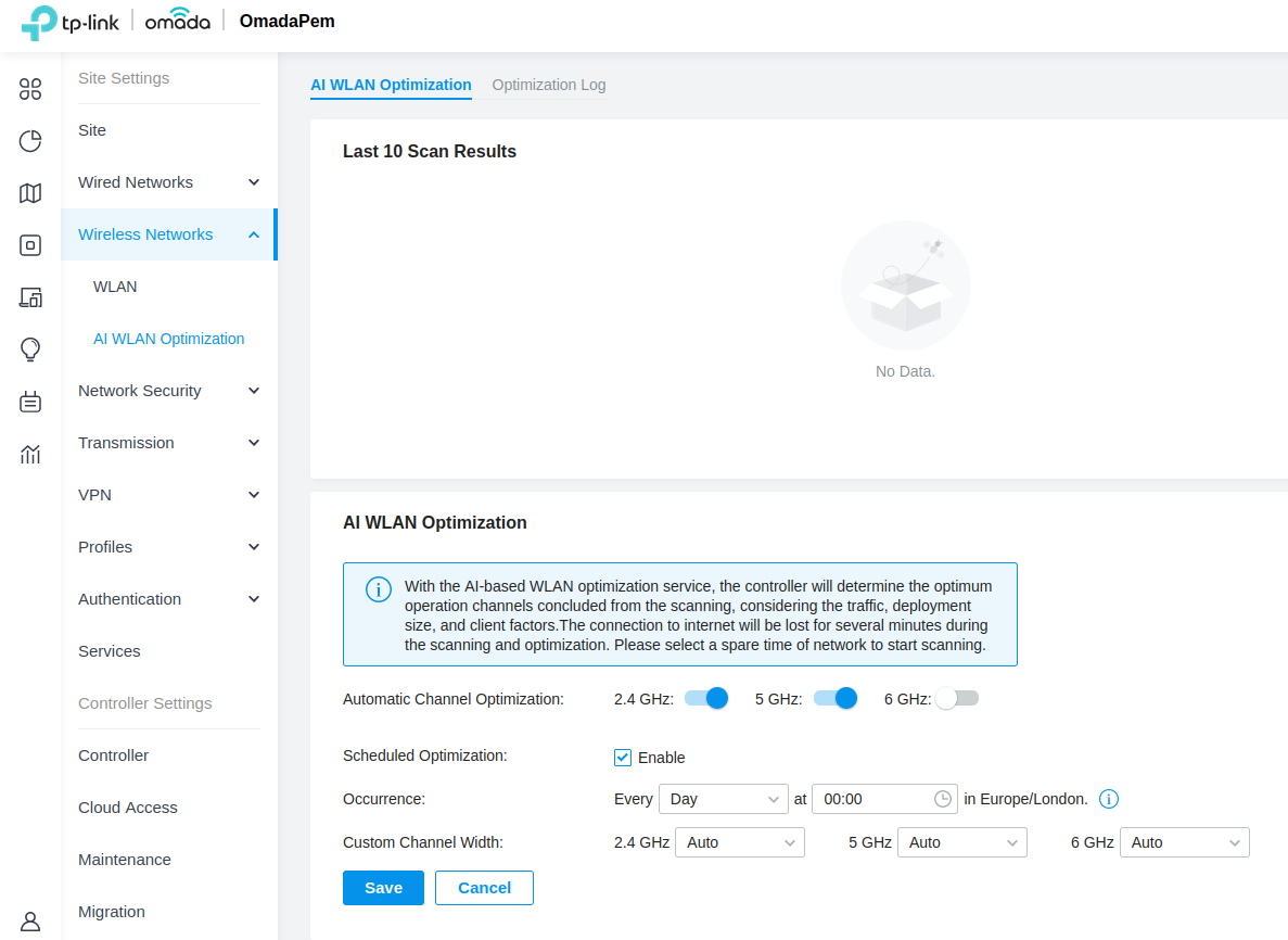

I’m running the TP-Link Omada controller for my AP, just updated the software to 5.5.6 and noticed this.
From the update, it seems the optimum channel is going to be determined! I wonder what happens when all the houses are running the same controller, how the optimum is selected !
