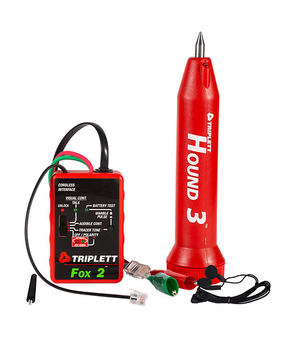

I have an ancient version 1 from the days before ethernet was really a common thing and it still works:
I also have an old Byte Brothers Real World certifier that works fine :
I also recently bought a Platinum Tools Net Prowler that works fine, though I want to buy one of their receivers to go with the kit. The old Hound is a little sensitive to noise.

In short, most of these toners work OK, and at some point will also drive you mad. With shielded cable all bets are off if the shielding is really doing it’s job.
