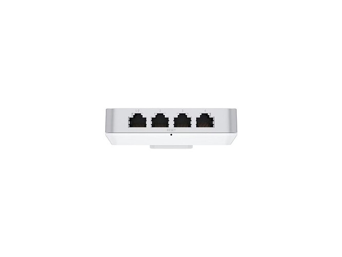

I manage to fix the problem with an ubiquiti Access Point AC In-Wall
Well that partially fixed my problem, I have now a very strange issue: https://community.ui.com/questions/all-APs-restart-when-I-try-to-ssh-a-host-behind-a-VLAN/31e3f1ed-d976-420e-9b88-6190c1325f8a
