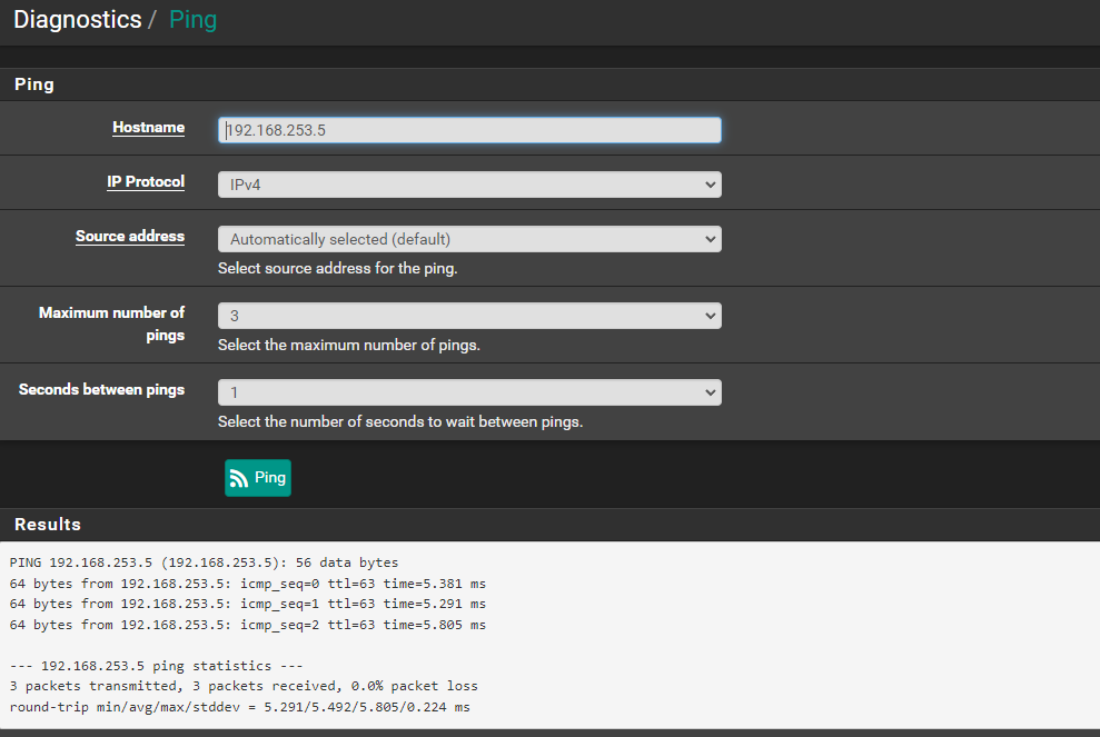

Im going to do that now… but i thought was odd that was that the tunnel is formed… and from the Pfsense ping diagnosis ping tab i can ping all the way to the device on the other network so. (src=192.168.2.3(the router) it can ping all the way to the end device 192.168.253.5) but from my computer on the lan side of the pfsense (src=192.168.2.7 i can not even ping the other side of the tunnel 10.1.2.2) I didnt know if that mean something along the lines that maybe its because my gateway is 192.168.2.3 vs 192.168.2.1) feels like it shouldnt matter but i dunno. on the edge router tho basically everything is allowed unless you drop it.
how about using the interface where 192.168.2.x is located as the source when you are doing ping test and see if you got the same result.
That works as well… I’m driving but I’ll screen shot that when I get to the office. Only doesn’t work from the actual lan… not reaching the other end of the tunnel gets me… computer can get to 10.1.2.1 but not 10.1.2.2.
