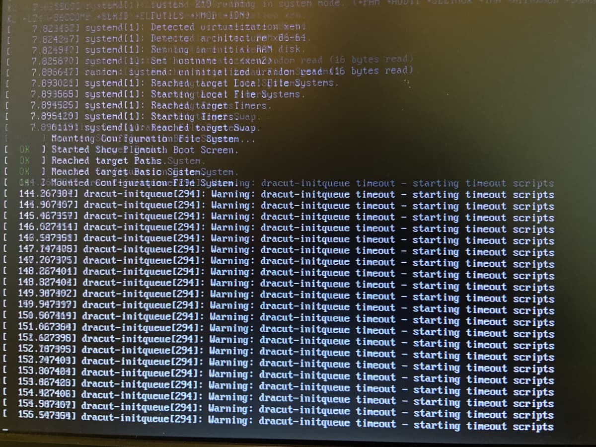

Current Error Message
Booting XCP-ng in safe mode, the logs look like:
[ OK ] Mounting Configuration File System
[ OK ] Started Show Plymouth Boot Screen
[ OK ] Reached Target Paths
[ OK ] Reached Target Basis System
[ 144 ] Mounted Configuration File System
[144.267384 ] dracut-initqueue[294]: Warning: dracut-initqueue timeout - starting timeout scripts
That last one repeats lots of times. Eventually I get this and it dumps me to a prompt where the keyboard doesn’t respond:
[ 205.134740 ] dracut-initqueue[407]: Warning: Could not boot.
[ 205.153475 ] dracut-initqueue[407]: Warning: /dev/disk/by-label/root-phrnjf does not exist
Starting Dracut Emergency Shell
What to do next?
All that changed from a booting system to one that wouldn’t was the firmware update, so I figure there’s gotta be some setting in there that’s toggled different that I can’t find. Any ideas?
If not, does it make more sense to just do a fresh install of the newest XCP-ng and start a new pool, then remove old servers from the old pool using the same process and migrate them over as well?
I’m really at a loss here.
I’d consider doing an upgrade to the newest XCP-ng on the affected server, hoping it would take the old settings and make the system bootable, but I know that’s the wrong way to upgrade Xenserver and I have no idea what additional problems that would cause between power it up and then promoting it to be pool master. If I could even get that far.
I doubt a screenshot helps, but here’s what I see in safe mode when the problem starts:
