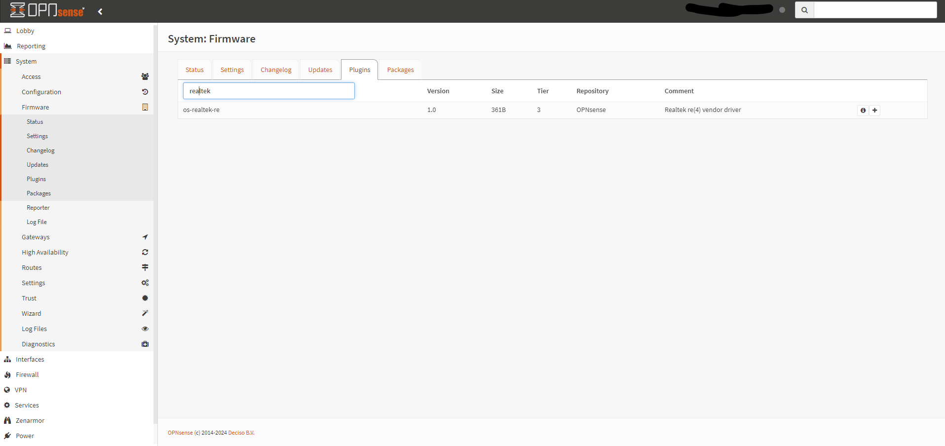

First off, the random freezes… the network freezes until a restart about 3 times a month. I still can’t think of an solution to this? One issue might be the Realtek Ethernet port on the router? So, should I try to disable it and switch any devices that use it to use the other available port on the Mellanox, mainly the modem? IDS is also not active. Though the weird thing is, when the freeze happens, you have to restart the whole network cabinet basically, not just the router… so an Uniffi issue?
