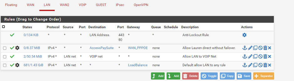

LAN is configured with multiple VLANs
Primary LAN: 192.168.16.0/24
VoIP LAN (VLAN22): 10.100.0.0/24
Guest LAN (VLAN50): 192.168.50.0/24
All switching is Unifi

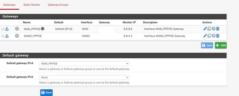

Both WANS have the gateway monitoring action & monitoring disabled.
Firewall Optimization options- Conservative
Load Balancing – Sticky Connections is enabled.
This system used to work perfectly fine, we have VoIP traffic to go via a specific gateway, ever since we updated to 23.05 clients VoIP phones keep dropping registration. We have tried the below on VoIP side, So if were to login to the yealink phone the phone would appear registered and after some time registration failed.

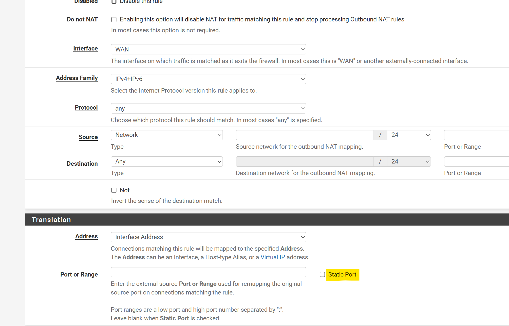

Go to NAT > Create a hybrid NAT rule that sets ports static during NAT.

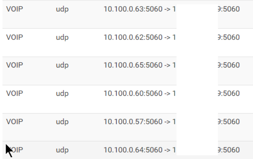

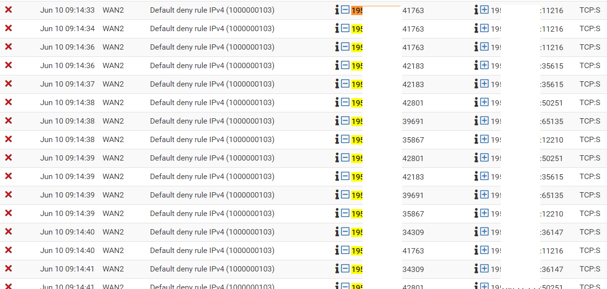

I have noticed this in the firewall logs, with the Public IP of the PBX showing.
I dont understand why it needs a port forward we have other pfsense with the same phone system that hasnt required anything different to this.
Would all the phones having the same local port cause an issue? or can pfsense handle this?

Did you try what I suggested about the static NAT? I am not talking about port forwarding, I am talking about outbound NAT keeping a static port instead of randomizing it (default in pfsense). And yes, source port is to be expected to be identical, depending on the service.
