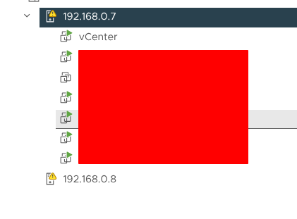

Looking to brainstorm something. I am in the middle of migrating VMs to proxmox from ESXI. Production VMs in a small business for a client.
They have 4 nodes. Mostly Dell PowerEdge R750xs servers, under warranty. VM storage live on the servers.
As of right now I have two ESXI servers left. Remaining VMs are on “Server7” Server 8 is empty.
(Server 7 VMs are being backed up daily with Synology Active backup.)
Then we have two Servers running proxmox. I have been converting VMs and so far so good.
Here is where I am not sure if I am worrying too much or over thinking things.
As of right now my thought was to just to convert Server 8 to proxmox then migrate all those VMs to server 8 then turn server 7 into proxmox and move VMs around.
But then I started to get nervous about that idea, if server 7 has a hardware issue after server 8 is already on proxmox, I then have no where to restore VM backups to since Synology active backup need an ESXI box. And I am not sure at this point how easy it would be to get ESXI back on Server 8.
  1. Can you still use old ESXI installers?
  2. Can you use them without a license?
Also, I checked and I am pretty sure I can fit all these VMs on the 2 proxmox servers that are currently up and running, empty these ESXI servers then convert them to proxmox. But with that I was a little nervous maxing out those two servers with VMs in case those have any hard ware issues during the switch.
  1. Am I over thinking this? These servers have been very reliable.
  2. What would you do?
Thanks!
