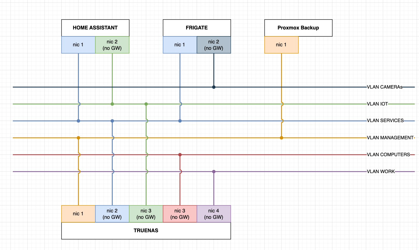

But, if I correctly understand, if one of these vms is compromised (ex. by some IoT device with malicious firmware), because of the 2 nics, all the vms on the “safe” network can been compromised since the attacker has a free access to this network. right?
So this could also be a problem even for TrueNas… is it so?
Because, while I am writing, I just figure out that I could have the same thing there, since I assigned it multiple nics
  • 1 main network (with gateway) - GUI, Proxmox storage, vm backups
  • 2 IoT network (no gateway) - music / video / photos
  • 3 services (no gateway) - nfs/smb for services
  • 4 truested (no gateway) - smb for pc/mac
  • 5 office/work (no gateway) - smb for company laptop (when I work from home)
See diagram
Sorry about the confusion. My point is not that network segmentation is complicated, it is that doing that trick I mentioned while running your router in a VM is complicated.
Your current setup is actually pretty good for network performance. You do not have the problems of a router on a stick. Looks like all your heavy throughput traffic will be on nic 2. If you have dedicated drives for those services, then I/O you should be in decent spot. Setting up vlans would be easy and help with L2 security.
Honestly, I would worry about reliability with your setup long before security or performance.
