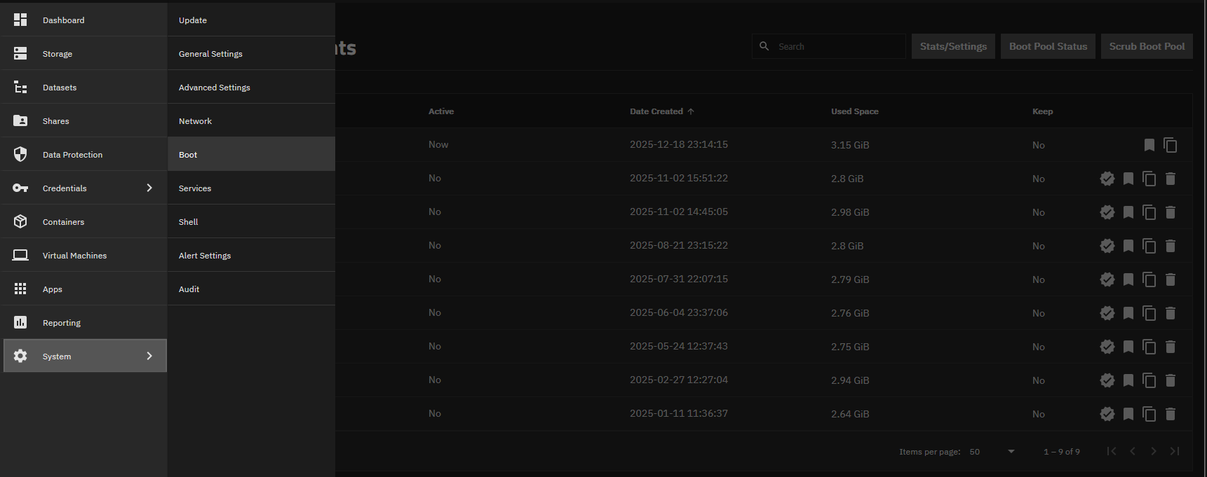

In terms of migration, missing the mark on that call is a bit tough, Is there any chance that you could roll your server back to the previously installed image version? I never had to do this during the migration period, so I can’t definitively say it will work, but, it should work, as I have had to do this several times in the past for other reasons related to GPU driver incompatibility.
That being said, regarding your actual wordpress conundrum, if there is absolutely no way for you to roll back and to retrieve your old configuration passwords/keys, you might be in for a rough go, just because even if you were able to migrate the data from your wordpress instance, and then rebuild the container using the docker image pointing at the datasets, without those encryption keys, I’m not sure how things would work at all.
I think your best course of action at this point would be to try the rollback, if successful, access your wordpress instance and export the site as well as the rest of your data, and try your best to locate the encryption keys if possible.

Here’s where you’d want to go in order to find and rollback to a previous boot env:
