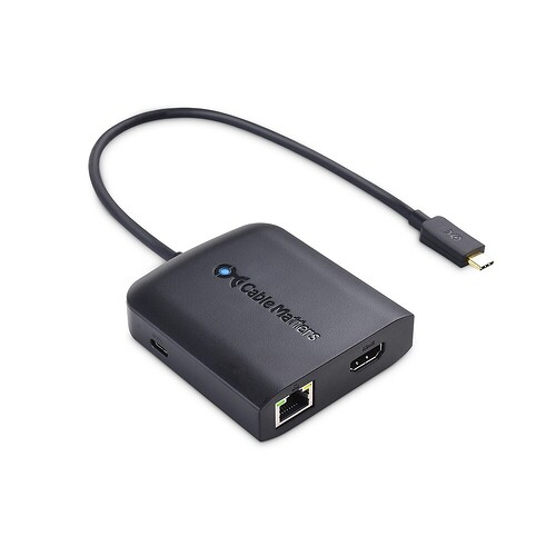

So I bought a cheap laptop to leave at work for many of the things I need to do with switches and network attached video devices. It has a USB 3.x A socket, and a USB C socket on the side, the USB C also has PD for charging. I need ethernet with this as well as USB-serial, etc. So I bought this device which should give me everything I need but one problem:
It does everything I need except that it requires a power supply to do anything. Part of the point of a laptop is to just hook up and get a job done quickly, not pull out power and plug it in, then get to work. Does anyone know of a device that will give me an ethernet connection (prefer gigabit), and the ability for PD charging when I need a longer term power source? A couple extra USB A or C ports would be handy in case I have serial and ethernet connected, and need a flash drive to pull firmware or some other function.
Bonus points: The same desired device that has PD and POE++, one of my switches has 90 watts per port, another 30 watts, plus I often have some 90 watts injectors connected where I’ll be working. This option may cost more than I’m willing to spend, but it might be neat!
