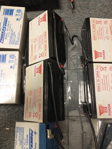

Recently I replaced all 12 of the SLA batts in both of my rack mounted Eaton 9130s with great 12V 9AH batteries from PowerSonic. As I am an IT service provider similar to LTS, I have done many of these renewals. Ultimately choosing a replacement came down to experience with cheap junk (lack of performance and longevity). The base indicator of quality has ended up being the individual weight of each of the batteries as they are SLA and more weight generally means more lead, acid and whatever else is used to construct batteries.
Have used PowerSonic for about 5.5 yrs now for all sorts of UPS and other battery powered items and they work just as good or better then OEM. For my business personal and clients, would say Ive done about 60 batteries or so now with no issues.
