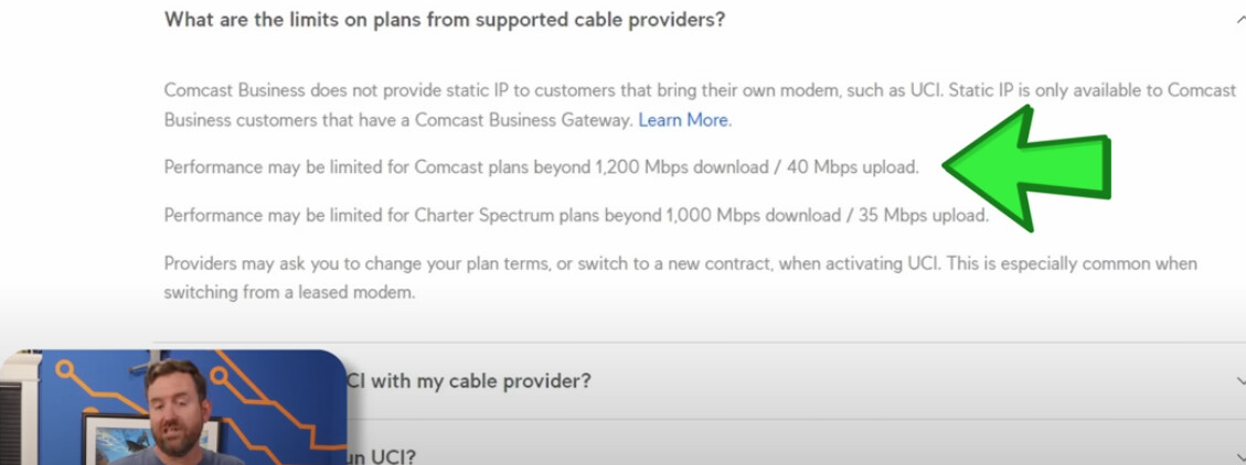

That modem is DOCSIS 3.0 and won’t achieve max speeds with Xfinity in my experience (even though it says it should). Xfinity may not let you get improved upload speeds with your own gear. Hadn’t been an issue for me for a long time with a CM1000 but I really wanted the boosted upload speed that came out. So I had to lease one of their modems and put it in bridged mode. Crosstalk talks about it in the Unifi cable modem review, although that might just apply to business accounts.

Funny you mention the Hitron CODA 56, I have one arriving tomorrow (to rule out anything else. As I have other Ubiquit hardware, I was looking at their UCI product, but they also looked to be capped at 40 Mbps from what I was seeing.
