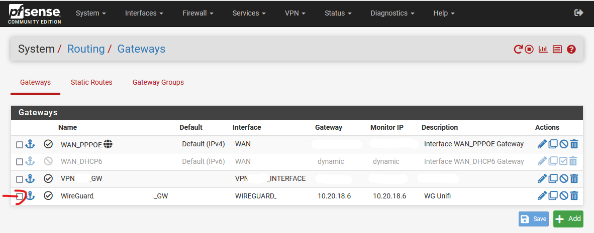

I´m trying to create a Site to Site VPN using wireguard between Unifi Express gateway and Pfsense. I already have the wireguard setup ( or that´s what i think) between the two, in the unifi I confugured as a WG client in both i can see that the connection is OK
Also I configured a gateway in Pfsense and a static route redirecting the subnet that is in the side of the unifi through the WG connection.

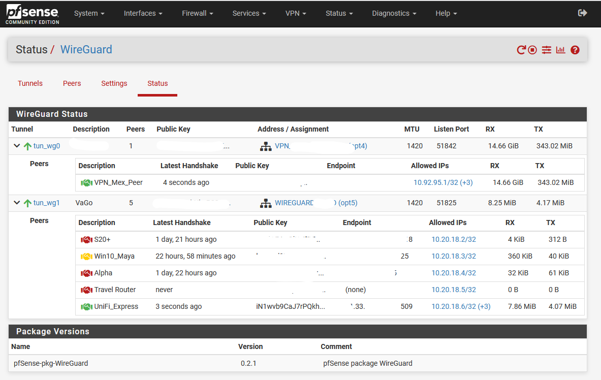

Thanks, but the issue is with the traffic from Pfsense to unifi, the other way (unifi to pfsense) is working fine.
I can´t reach the unifi subnet or go to the internet throught unifi if I´m in pfsense. On Pfsense I got an interface with the WG peer, a gateway and a static route to reach the unifi subnet
I´m quite shure it have to be something with routes or firewall rules in unifi because I have other VPN where a unifi UCG Max is the wireguard server and the same pfsense is a client and it works perfect in both ways.
