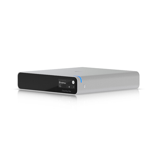

With that said you would need something like the cloud key or the UDM lineup to connect it all together. I’d recommend using the capacity calculator to decide if it will work for you.
Not clear or maybe I am misunderstanding why you would suggest a Cloud Key if they are going to run the UniFI OS server.
If you look at something like the Cloudkey Enterprise for a hardware comparison it had a 16-core Intel® Xeon®-SP Gold 5218 at 2.3 GHz and 16GB and was able to manage 1,000+ UniFi Network devices and 10,000+ clients. I imagine more of the limitations with the UniFI OS server would be related to the amount of resources you are allocating to it.

Because they mentioned cameras and an NVR. The NVR is a separate deal and cannot be adopted into the OS server.
