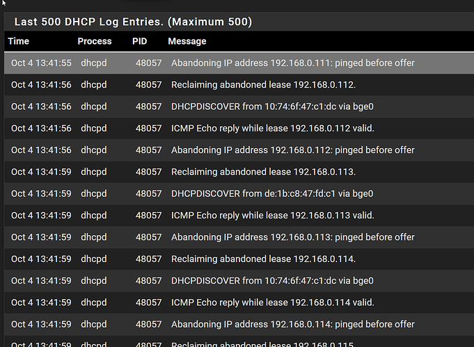

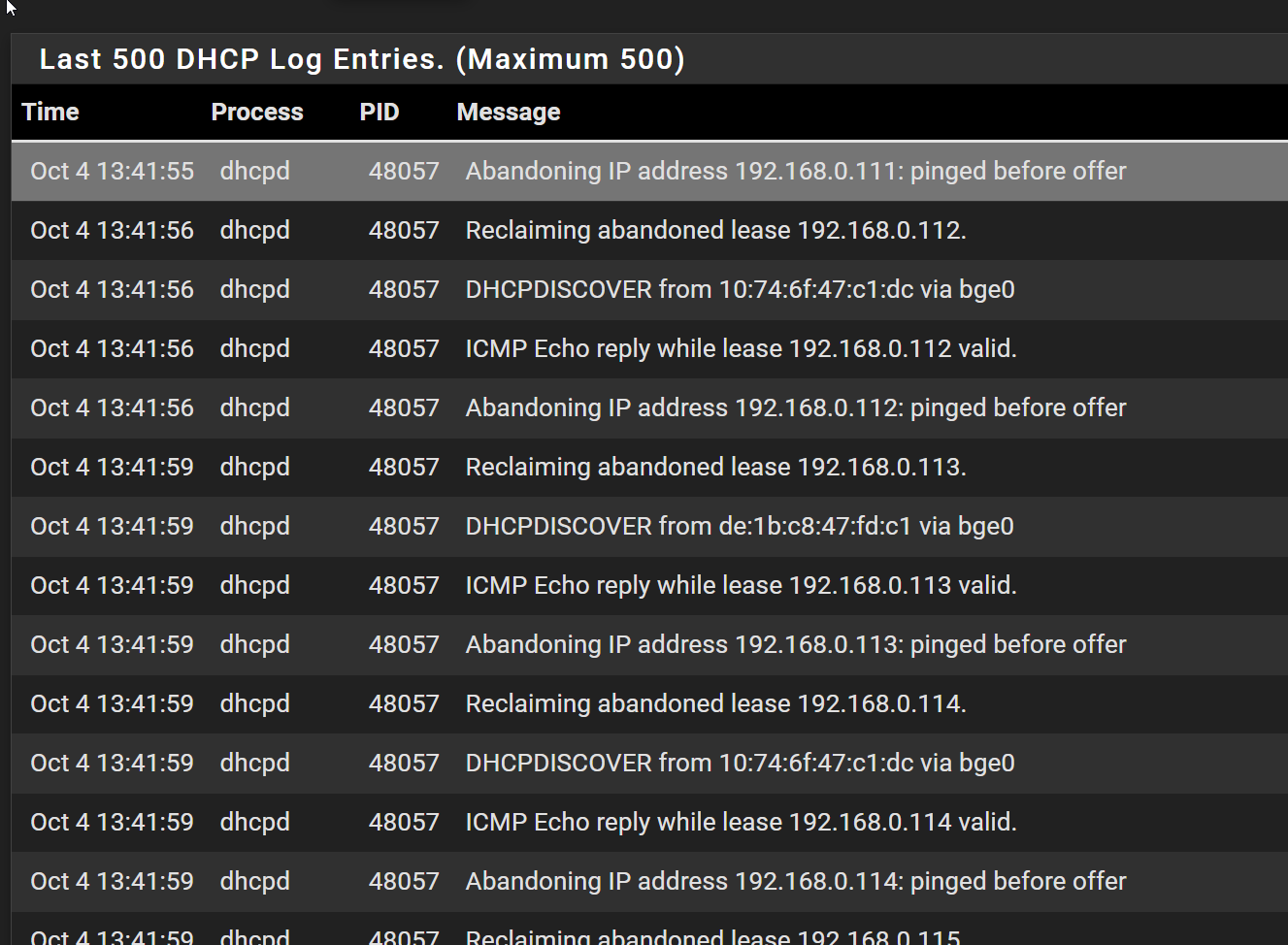

I’m too familiar with what DHCP packets on a healthy, network, but there is nothing at all for DHCP when I do a capture with no filters on the LAN network at the pfsense end even for devices that successfully connect. At the device end, there are lots of BOOTP requests going out and no responses.
However, I think that there is a pfsense issue as the capture window shows no lines and doesn’t limit the capture to a 1000 lines. Yet the capture file is full of packets when I download it. It was working fine a few days ago before updating to 2.8.1. Since updating, lots of things have broken in pfsense including the acme cert manager, the package manager and now the packet capture. But I don’t think this has anything to do with the DHCP issue (the issues predated the update, and I tried other DHCP servers. The DHCP logs also fill up pretty quickly with ISC DHCP, but I did also try Kea instead just in case that was the issue. But there are no logs to be seen on Kea.

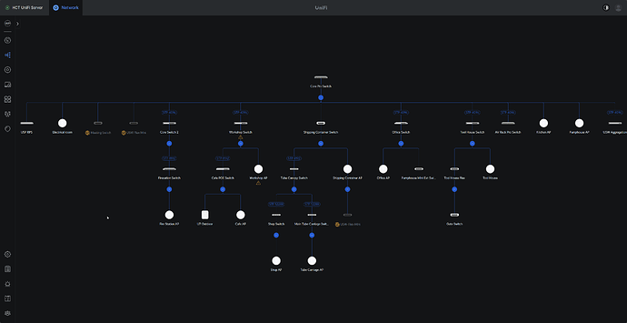

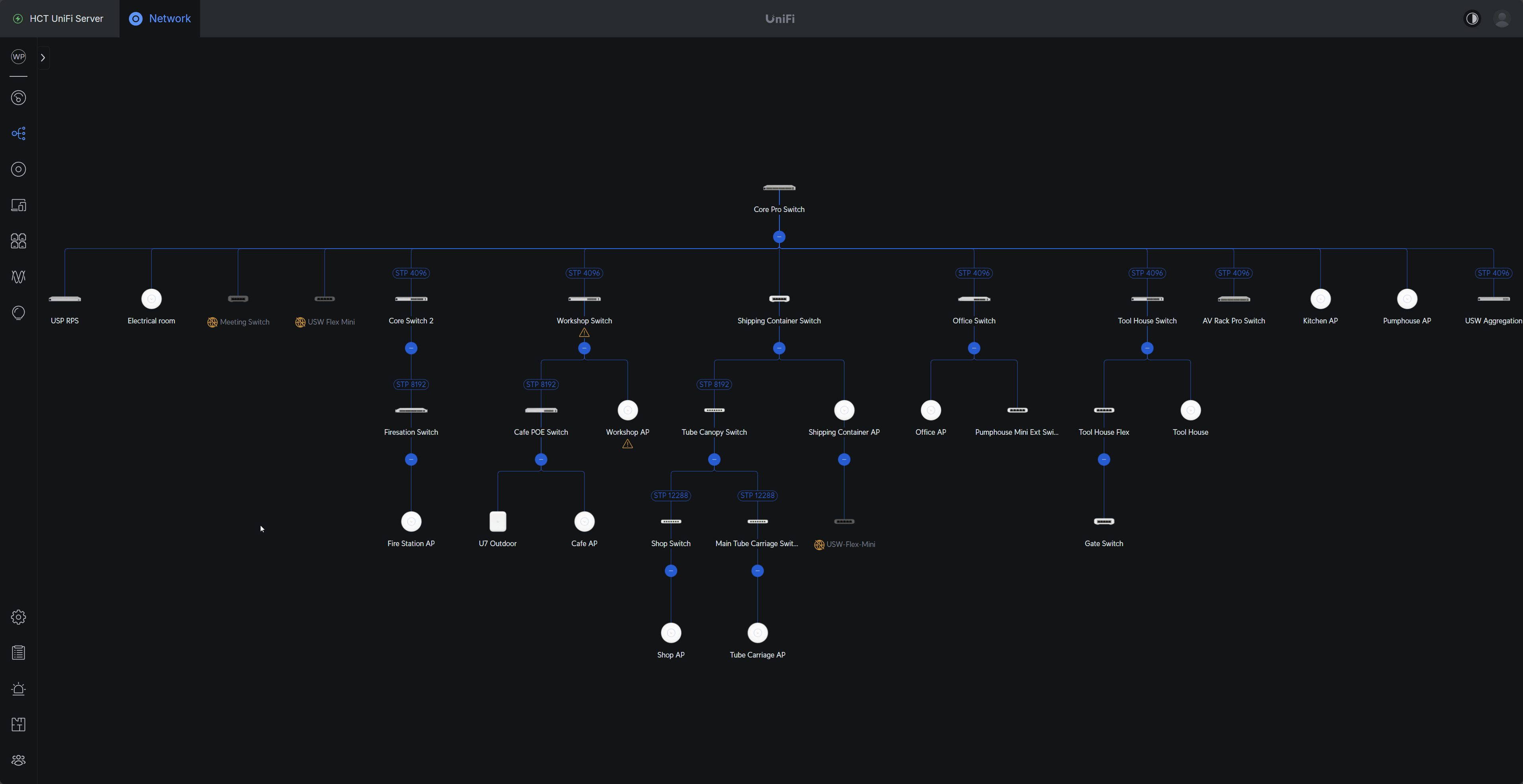

Plugging a device directly in the (pfsense) router work fine. When I tried OPNsense, I disconnected the pfsense server physically from the Core Pro Switch and plugged the OPNSense box into the Office Switch. The issues where just the same even with OPNSense doing DHCP. The moment I unplugged the office switch from the wall (the uplink port to the core switch), the laptop I was testing with instantly got an IP. I then tried to physically unplug everything one by one from the Core Pro Switch but nothing made any difference. I’ve attached the topology to explain the layout.
Where is your dhcp located in this network map?
Have you tried just having your DHCP connected to your main pro switch, disconnect all the switches. Plug in an endpoint verify it is working. If so, then adding each switch one at a time and verify dhcp operational. I assume your dhcp scope isn’t filled (all in use) up too?
From your description its not the DHCP server that is the issue, but a connection back to the dhcp from.end points.
Also, is there a reason foe all these cascading of switches? These should be going back to main aggregation link. Why do you have a aggre2switxh with nothing connected?

@randybell In answer to your question the DHCP Server is located on pfSense which is connected to a trunk port on the main pro core switch. But I also tried Windows DHCP server and OPNSense. DHCP. There are two ranges on the LAN and on is at 22% utilisation and the other is at 25. 155 total in the first range and 253 in the second.
The cascade of switches is due to a less than ideal physical site layout, but this has never caused issues before other than easily resolvable STP issues with third party unmanaged switches. The aggregation switch is temporarily being used a storage interconnect to connect a Synology and a truenas server to two XCPNG hosts. Not ideal, but there’s not yet enough ports on the servers for a direct link. The uplink on the aggregation is purely for management, and the storage network is on its own VLAN with no DHCP at all.
