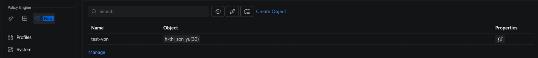

This is the rule:
rule

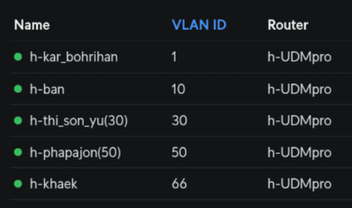

I changed the router-setting for every network to be the UDM:
but that, having different Routers, wasn’t the source of my little problem…
Are you using the policy manager to create that rule?
This last one I created with this new object-oriented manager
So the surf shark tunnel is up, the policy route is set with a kill switch, but the device still shows your ISP as the address when going to a site such as https://ifconfig.co/ or https://ip.wtf/ ?
yes!! exactly…

Hmm…
I think I know what it is…
If I select a Router for a network that is not the UDM I do get this behavior, that the traffic of the vlan will not be routed through the vpn-tunnel!
And that was is most important in my eyes - the kill-switch - is doing nothing in this situation… the traffic reaches the wan and going through the non-vpn-connection. Don’t know what to say…
