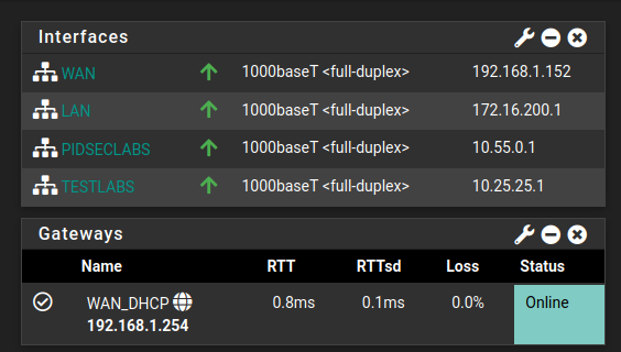

Here is my full network segmentation

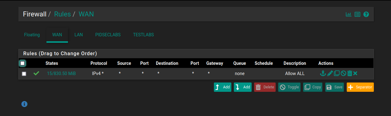

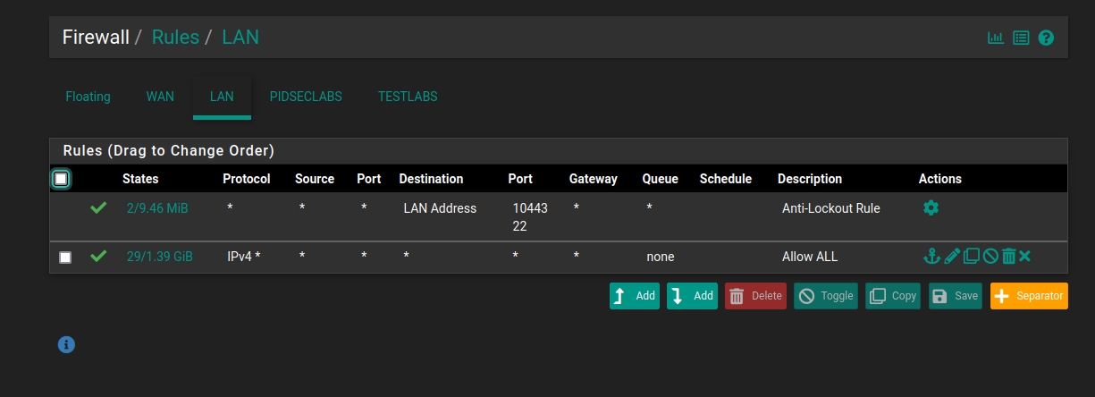

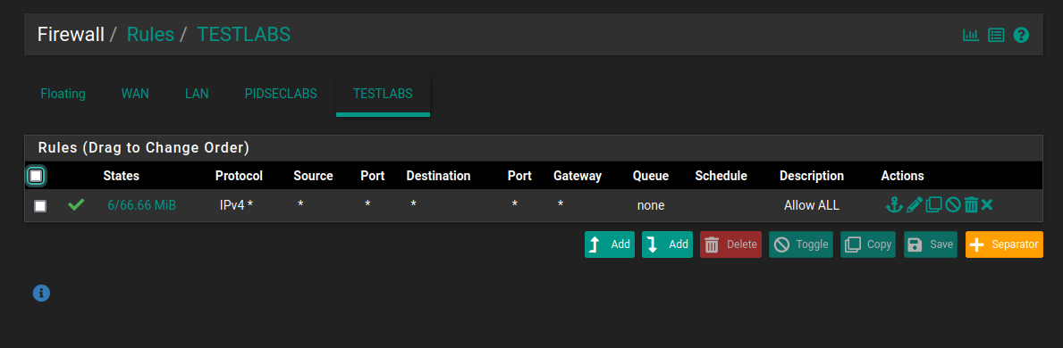

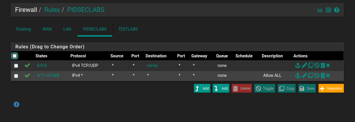

here are my firewall rules each interface

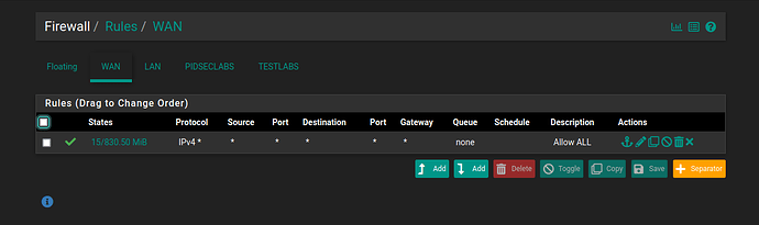

nothing is blocked for local networks for either interface and I simple enabled open access to all network segments.
Interestingly, My LAN subnets can access the jellyfin server on the pidsec subnet.
Even my testlabs subnet hosts can access the jellyfin server on the pidsec subnet.

You can see I have another rule for the server. I have tried it with and without the rule, even switched the rule from top to down.

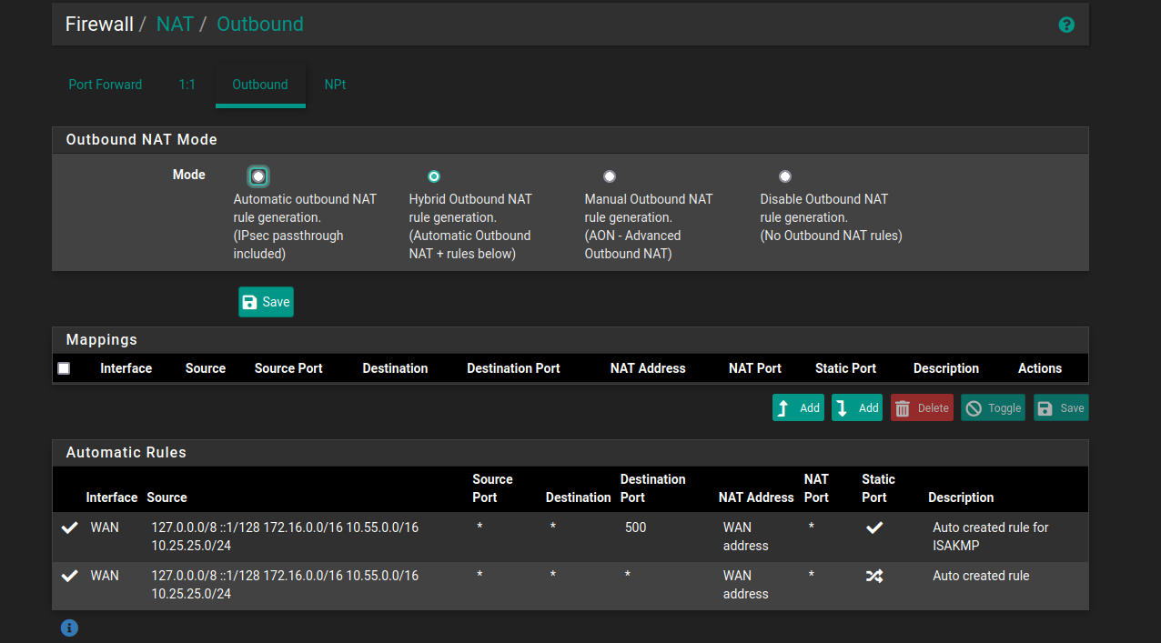

even further, Not sure if this had anything to do with anything but I have even tried changing the NAT outbound here
I tried the first two, and my issue still persist. Note that when it was working, it was on the first Automatic Outbound NAT mode. I don’t believe the other two options will fix the issue to my limited knowledge of networking.

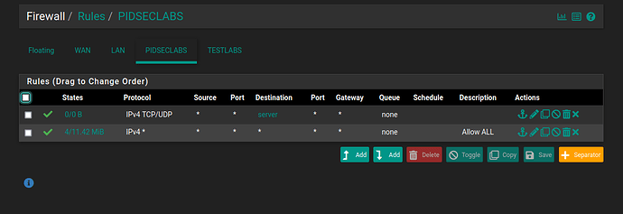

Just to prove the fact. I have nothing locally blocked on all interfaces

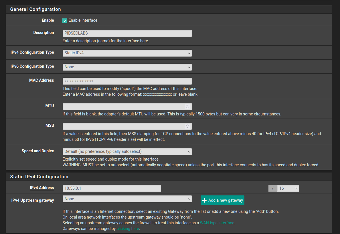

And here is the basic config for the pidsec labs interface
It has the same specs as the other interfaces besides a different IP obviously.

in the pidseclabs, can you move the second rule (allow all) as the first rule?
The first rule has dest ‘server’ which I dont know where it points.
yeah. I moved the rule up and still didn’t work.
