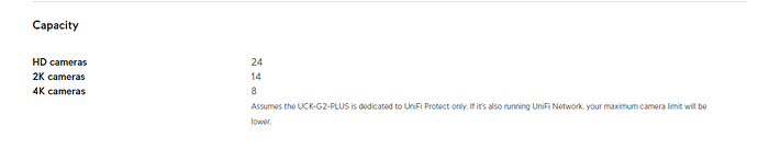

On my cloud key Gen 2+ here is my main load running 2 HD cameras. I’m also running unifi and innerspace on the cloud key.
I see the cloud key lists the following:

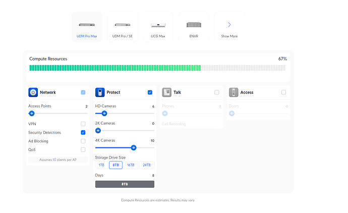

I don’t know how many 4K cameras you are going to run. Its possible it can handle cameras on top, but there is this calculator for the pro Max on load.
Check out their calculator. Here is an example.
