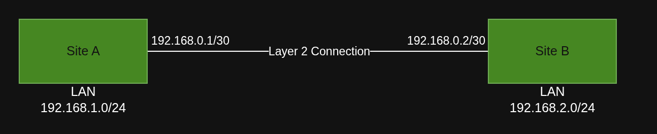

I see, so you have a layer 2 between sites. This is what I would do. I would still have separte subnets but if you need to reach resourses on site A then create a static route for it. Look at this diagram.
Site A Static Route:
  • Destination network = 192.168.2.0/24
  • Gateway = 192.168.0.1
Site B Static Route:
  • Destination network = 192.168.1.0/24
  • Gateway = 192.168.0.2
You’ll need to create the interface and connect it to pfsense. Then make sure to set the firewall rules properly. Then you should be all set. In this way the traffic at each site will go out its own internet.
This is the way. 2 subnets is the way to go. Bridging the LANs is not recommended. Having different subnets make it logically a better solution and will allow you to create rules for handling your LAN to LAN traffic the way you have stated and direct Internet traffic to each specific sites internet connection (split connections). Further gives you more specific DHCP setting control especially at the remote site, so if your DHCP server (vpn connection is offline) at least your endpoints can access internet and local resources (e.g. printers, local shares). Your bridging the physical remote lans together actually makes it more complicated.
