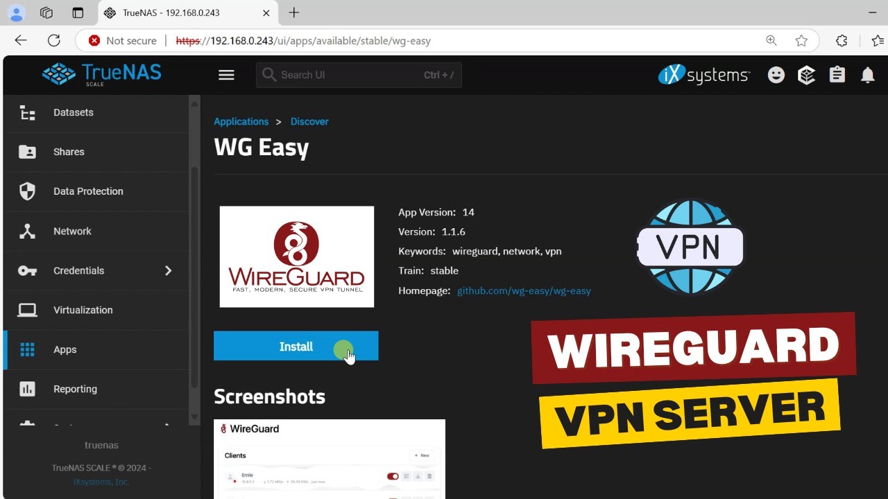

I didn’t saw the video but from the description the content creator create VPN server on TN.
I already have the server on the pfsense router at my home, what I would like to do is do the opposite, create a client on the remote truenas and let it connect to my network.

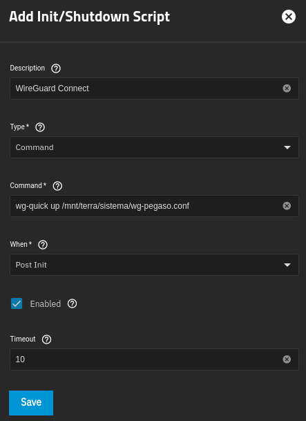

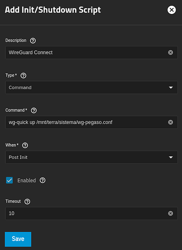

Can someone confirm that what I did is fine? or there is a better way?
truenas_admin@pegaso[/mnt/terra/sistema]$ nano /mnt/terra/sistema/wg-pegaso.conf
truenas_admin@pegaso[/mnt/terra/sistema]$ pwd
/mnt/terra/sistema
truenas_admin@pegaso[/mnt/terra/sistema]$ chmod 600 /mnt/terra/sistema/wg-pegaso.conf
truenas_admin@pegaso[/mnt/terra/sistema]$ ls -ln
total 5
-rw-------+ 1 950 950 332 Jan 28 18:33 wg-pegaso.conf
truenas_admin@pegaso[/mnt/terra/sistema]$ sudo wg-quick up /mnt/terra/sistema/wg-pegaso.conf
[sudo] password for truenas_admin:
[#] ip link add wg-pegaso type wireguard
[#] wg setconf wg-pegaso /dev/fd/63
[#] ip -4 address add 172.16.99.20/24 dev wg-pegaso
[#] ip link set mtu 1420 up dev wg-pegaso
[#] resolvconf -a wg-pegaso -m 0 -x
[#] ip -4 route add 192.168.203.0/24 dev wg-pegaso
truenas_admin@pegaso[/mnt/terra/sistema]$ sudo wg show
interface: wg-pegaso
public key: --- nascosta :) ---
private key: (hidden)
listening port: --- nascosta :) ---
peer: --- nascosta :) ---
preshared key: (hidden)
endpoint: --- nascosto :) ---
allowed ips: 172.16.99.0/24, 192.168.203.0/24

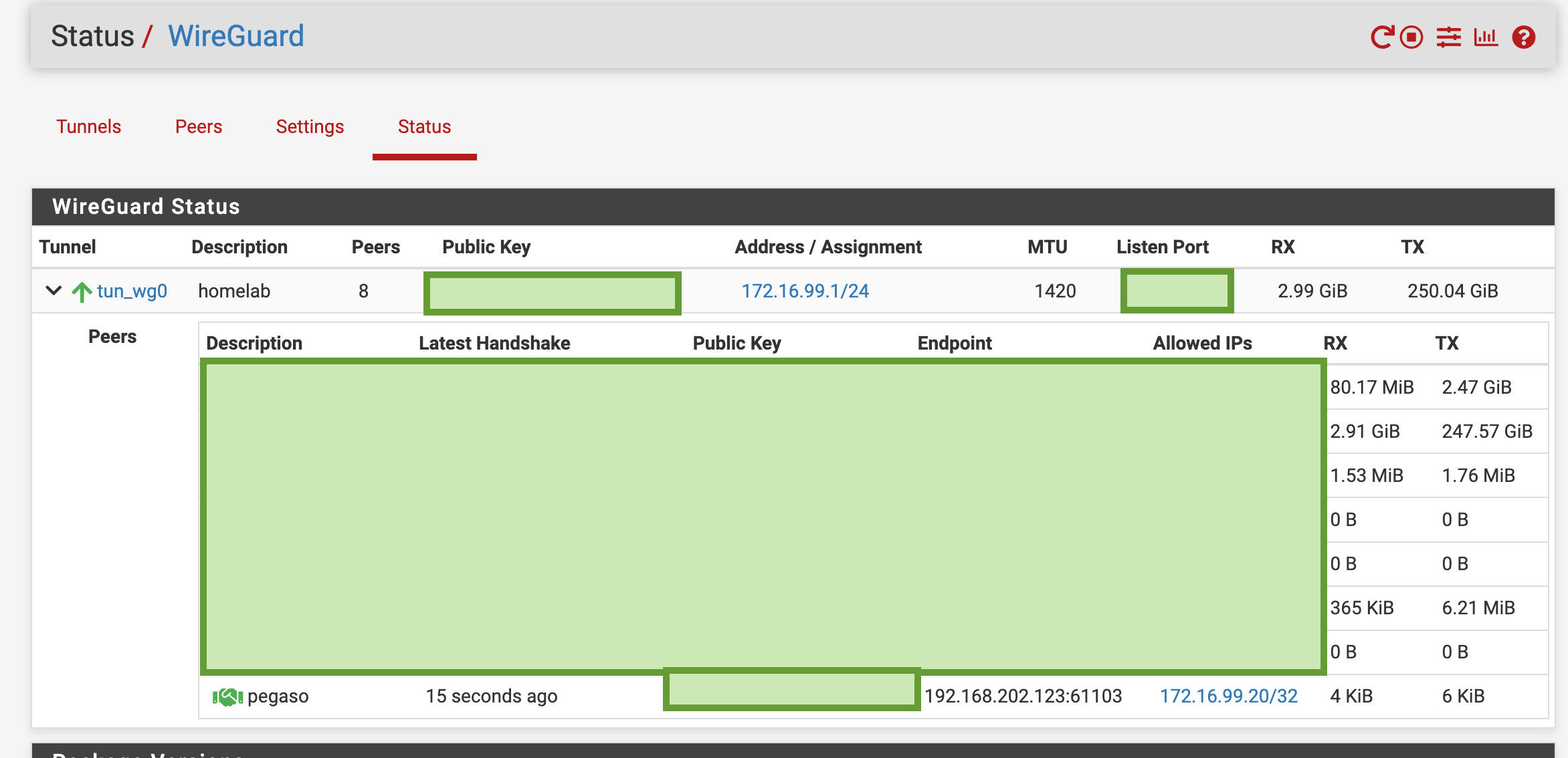

on pfSense (my network)
