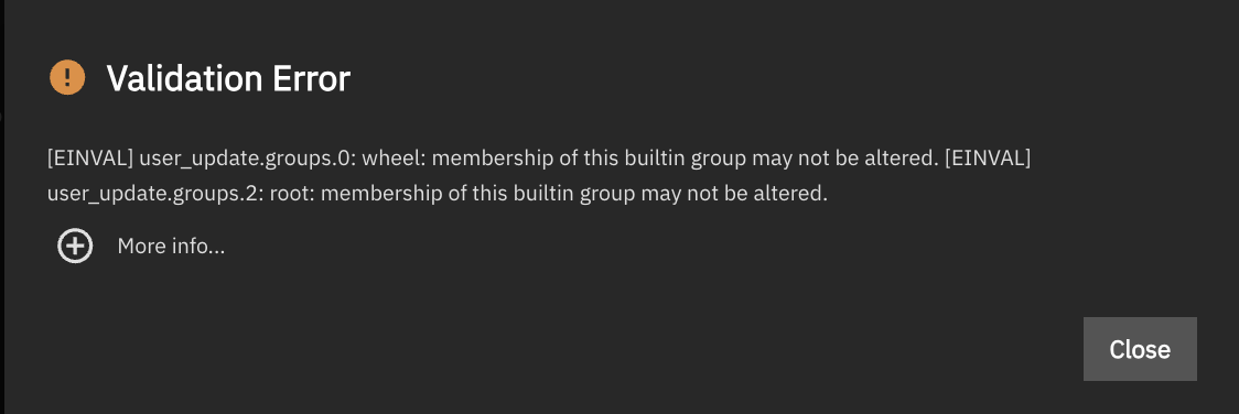

Traceback (most recent call last):
  File "/usr/lib/python3/dist-packages/middlewared/api/base/server/ws_handler/rpc.py", line 323, in process_method_call
    result = await method.call(app, params)
  File "/usr/lib/python3/dist-packages/middlewared/api/base/server/method.py", line 52, in call
    result = await self.middleware.call_with_audit(self.name, self.serviceobj, methodobj, params, app)
  File "/usr/lib/python3/dist-packages/middlewared/main.py", line 911, in call_with_audit
    result = await self._call(method, serviceobj, methodobj, params, app=app,
  File "/usr/lib/python3/dist-packages/middlewared/main.py", line 720, in _call
    return await methodobj(*prepared_call.args)
  File "/usr/lib/python3/dist-packages/middlewared/service/crud_service.py", line 266, in update
    return await self.middleware._call(
  File "/usr/lib/python3/dist-packages/middlewared/main.py", line 731, in _call
    return await self.run_in_executor(prepared_call.executor, methodobj, *prepared_call.args)
  File "/usr/lib/python3/dist-packages/middlewared/main.py", line 624, in run_in_executor
    return await loop.run_in_executor(pool, functools.partial(method, *args, **kwargs))
  File "/usr/lib/python3.11/concurrent/futures/thread.py", line 58, in run
    result = self.fn(*self.args, **self.kwargs)
  File "/usr/lib/python3/dist-packages/middlewared/service/crud_service.py", line 294, in nf
    rv = func(*args, **kwargs)
  File "/usr/lib/python3/dist-packages/middlewared/api/base/decorator.py", line 101, in wrapped
    result = func(*args)
  File "/usr/lib/python3/dist-packages/middlewared/plugins/account.py", line 874, in do_update
    verrors.check()
  File "/usr/lib/python3/dist-packages/middlewared/service_exception.py", line 72, in check
    raise self
middlewared.service_exception.ValidationErrors: [EINVAL] user_update.groups.0: wheel: membership of this builtin group may not be altered.
[EINVAL] user_update.groups.2: root: membership of this builtin group may not be altered.
I fully admit I didn’t know what I was doing years and years ago, thus my concern with copy/pasting semi random things into truenas CLI a decade ago. But this instance was set up about 5-6 months ago, and I certainly know my way around things and know what not to do to an appliance such as truenas… so I am not sure what I could have done to get whatever this above issue now is. Like I said, I did instal oh my zsh in my local user (maybe shouldn’t have, maybe I need to learn that leasson as well… don’t dork with appliances at all), but besides that, I have no idea what is causing this above issue where I can’t even save my account info in the webUI. For the above (non realted) issue, turns out, it really doesn’t like my user being part of root and wheel, weird, since that has been the case…. forever? So, disregard the above “new issue”, but hey, interesting non the less.
