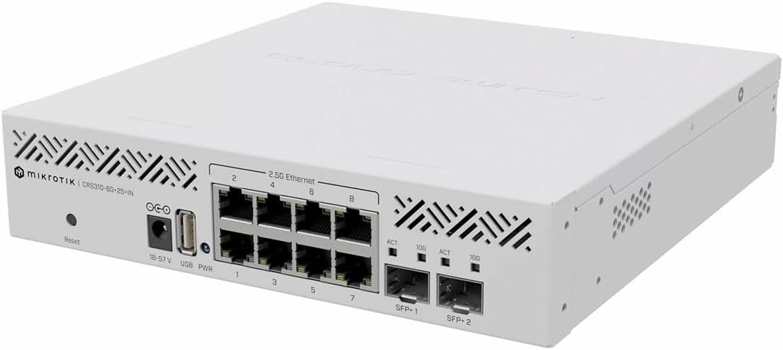

You may want to consider upgrading your switch if you are dead set on SFP+. Something like this may be suitable

I will need to upgrade my switch at some point for sure. Tho ill probably look for something a bit bigger than the one you listed (and i cant say that the lack of information and reviewers complaining about the quality of it gives me confidence in that MikroTik one either)
