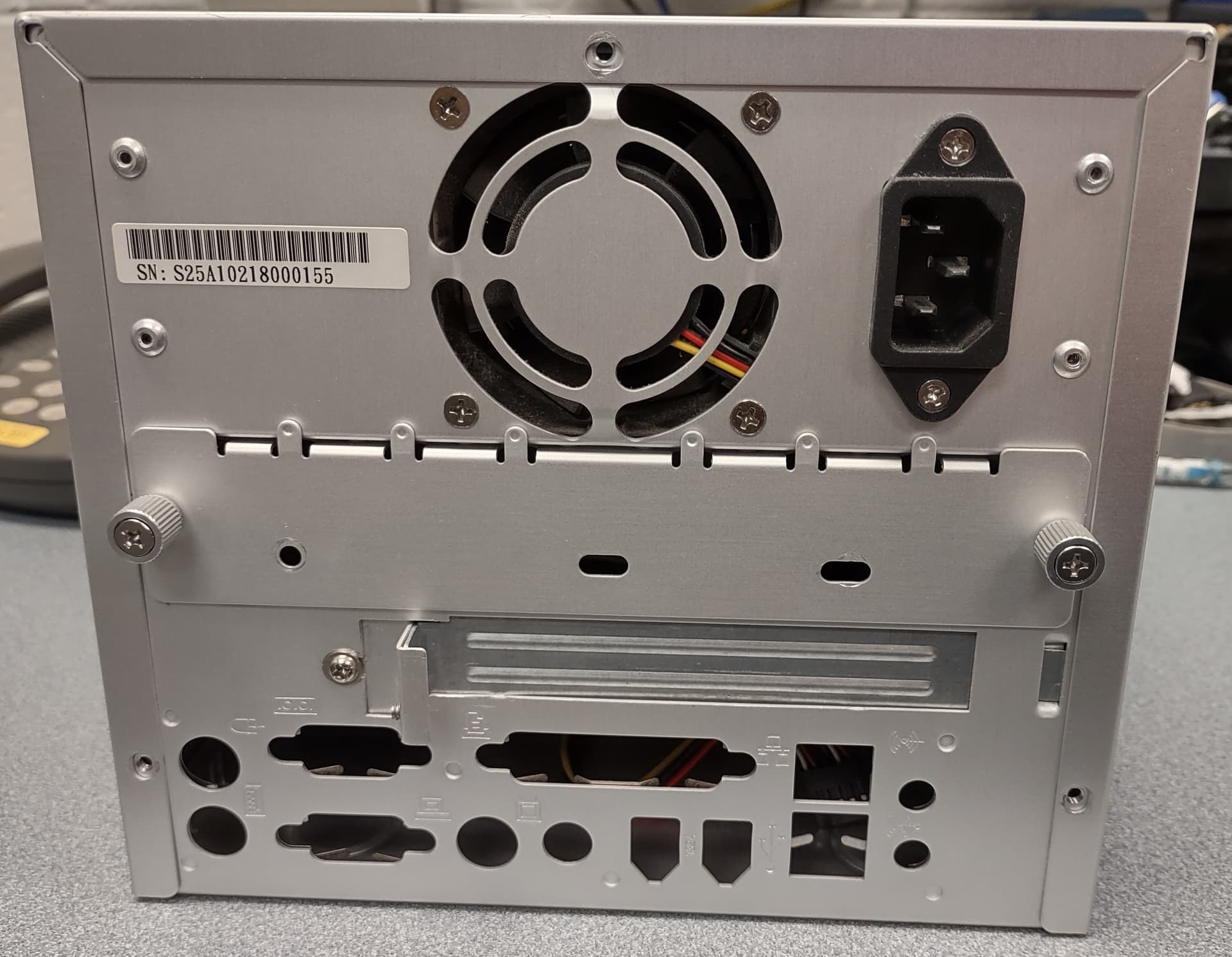

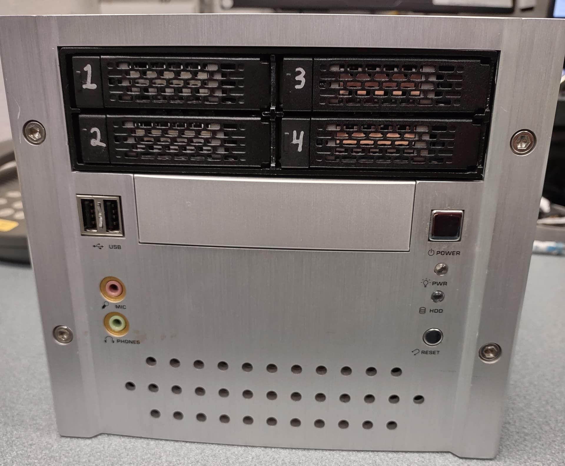

Other details: I have an Icy Dock 5.25 to four SATA, plus a 3.5 inch bay for another two SATA drives, need an OS drive connection or I drop back to 5 drives in the array. Want to go to 1TB SSD or maybe 2TB SSD if I catch a good sale. I can power by small ATX or DC input, not partial to either. Case is an old Shuttle SV25 which needs some work to fit everything, but I have it and if the board takes it, a 20 pin ATX supply inside. I also have a pile of DDR3 RDIMM and a few different sizes of DDR4 SODIMM if something works with those.

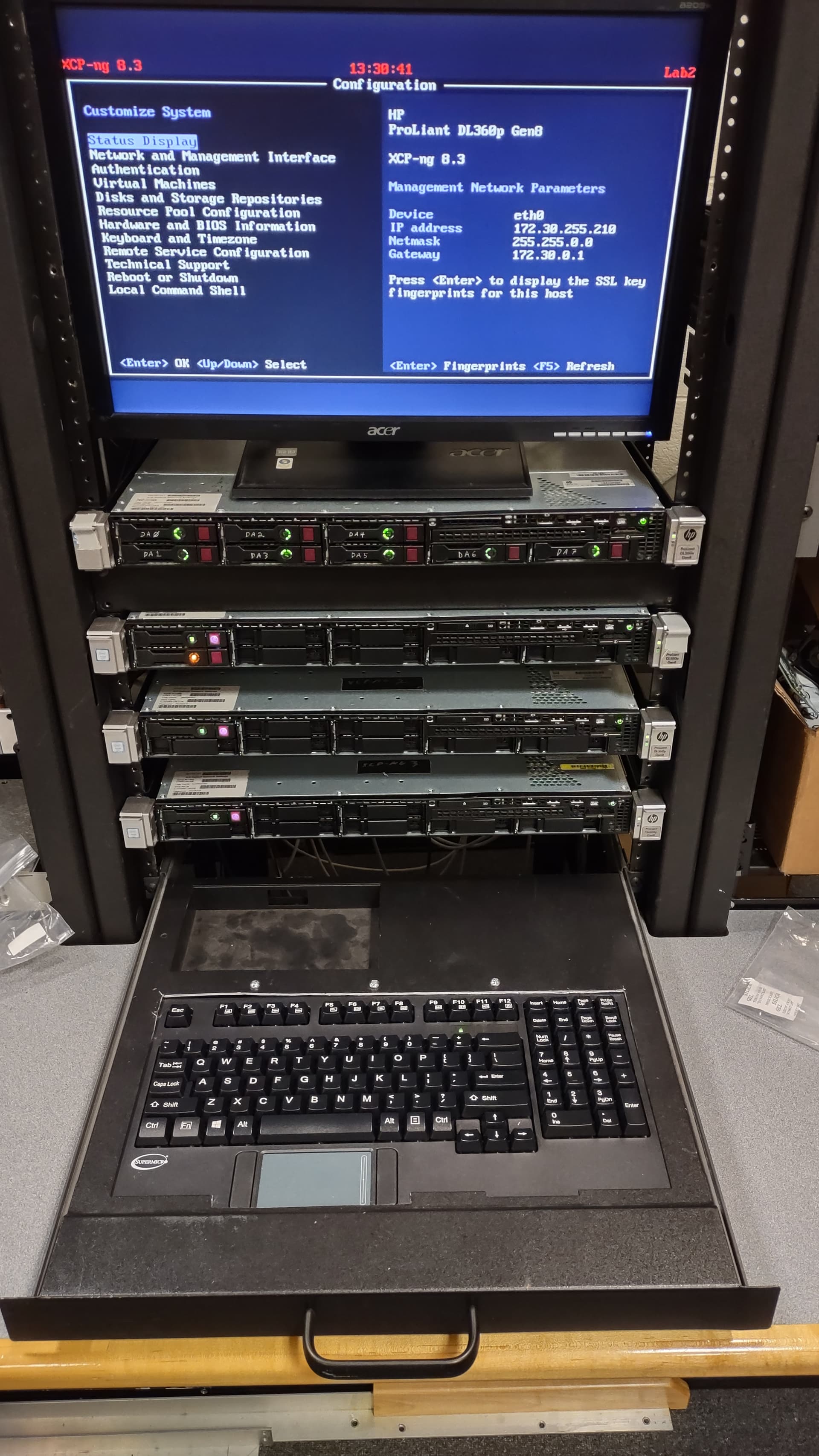

Here is my current room heater
HP DL360e Gen8 for Truenas 8x 512 spinning drives 96gb of ram
HP DL360p Gen8 for XCP-NG 128 gb of ram each
