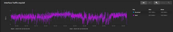

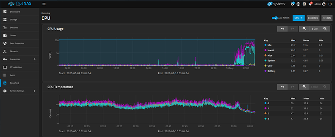

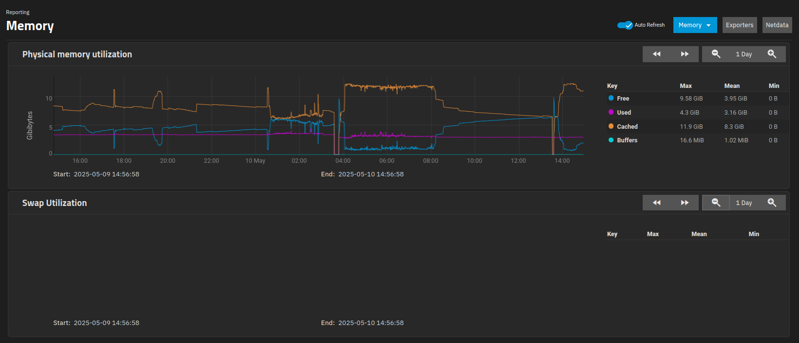

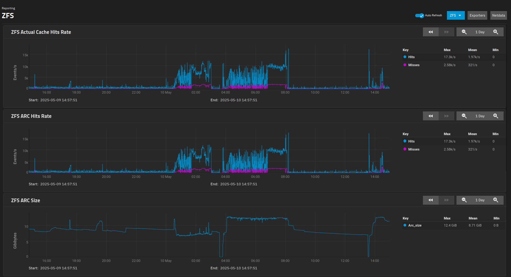

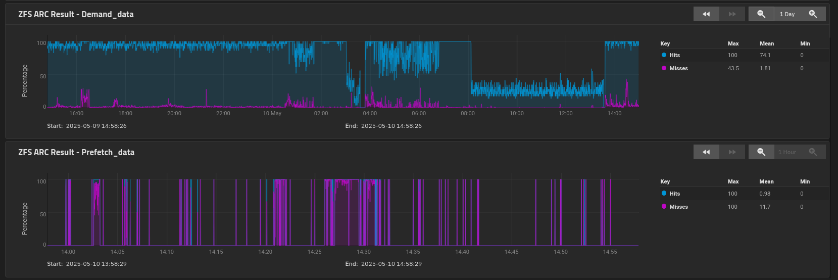

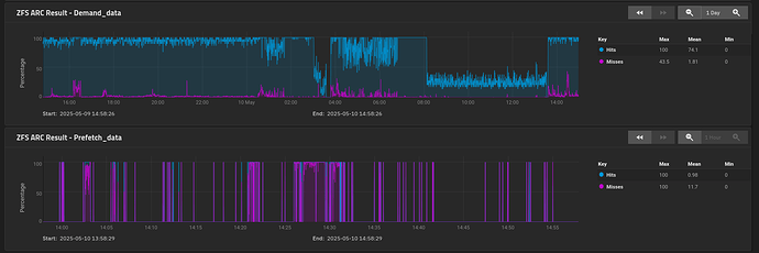

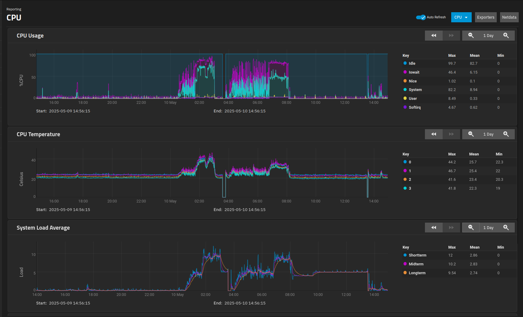

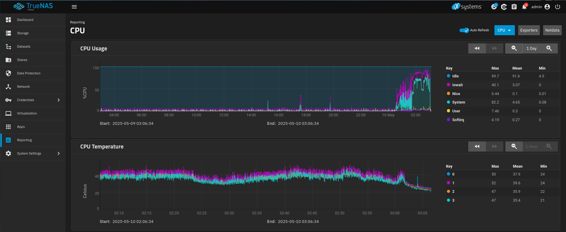

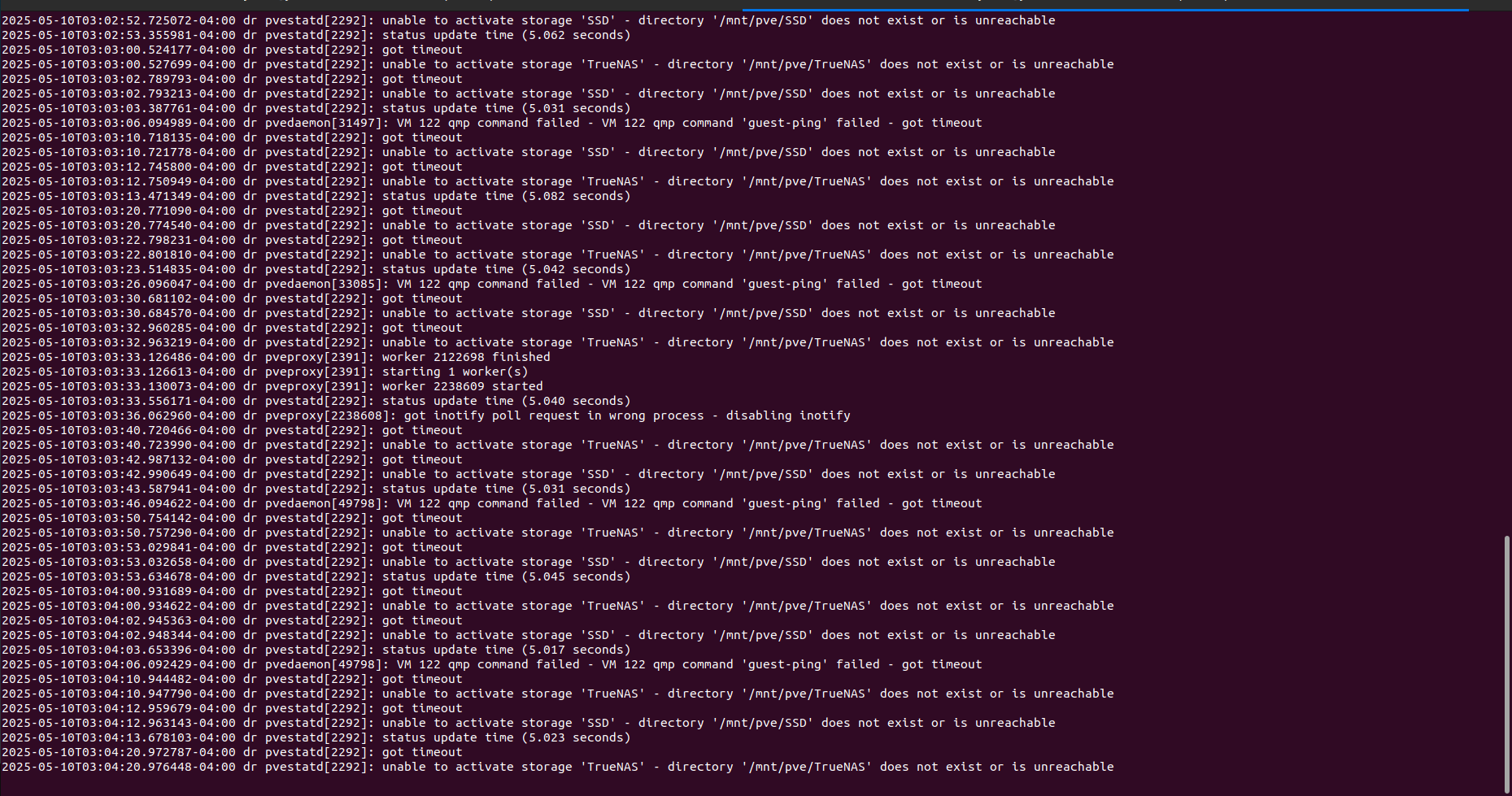

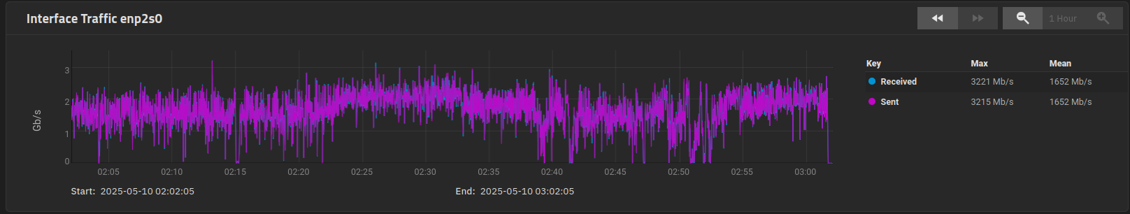

I’ve had a TrueNAS server running since about last September and it’s been mostly stable. I had a couple of issues where NFS directories mounted on Ubuntu / Debian VMs took over 5 minutes to run a simple ls but I think I figured that out. I ended up storing some of my Proxmox VMs on the TrueNAS over NFS and around 1:30 this morning, Proxmox disconnected from TrueNAS for the first time. I noticed that starting at midnight, Veeam (which uses TrueNAS over NFS for backup storage) was pushing some heavy data over the network - around 2gbps. I tried to get Proxmox to reconnect but the connection attempts just hung. I tried manually mounting a random NFS share and that hung too. I ended up rebooting TrueNAS after Veeam was done, rebooted an ran fsck on my VMs that are stored on NFS. All was good and I went to bed. I woke up and found that it had happened again. Same thing with Veeam pushing heavy traffic, nfsd threads showing as D in top… So I repeated my steps from this morning again and everything is working for now. I limited the Veeam backup storage to 150 MB/s and increased the number of nfs threads to buy me some time to notice the issue if it happens again and gracefully power off my VMs before rebooting TrueNAS. I haven’t changed anything in months - everything’s been stable and then this happens twice in the span of a few hours. My girlfriend and I both mount our Steam drives over iSCSI on this server and when we play battlefield together we can push between 1 and 2 gbps and this has never happened. I haven’t made any changes to Veeam, Proxmox, or TrueNAS in months. Can anybody tell me what’s going on here? Any insight would be greatly appreciated.
I’ve attached some screenshots of logs and graphs during the incident.
Screenshot from 2025-05-10 03-25-19
Screenshot from 2025-05-10 03-27-58

Did your lockups seem to correspond with heavy load either from your hypervisors or from somewhere else? Did you see if your NFS threads were stuck in Uninterruptible Sleep? Do you remember how much RAM you had available in your TrueNAS system when that happened? I’m curious if there are any similarities that may help us point to the root cause.

It was hard to tell. It was random from a long time. Some days I can go a week and other seem to happen within a day. But I figured out it was NFS because If I didn’t run my VM’s, I didn’t have any issues. I didn’t get any metrics, but I am monitoring all these things now. So we will see.
So, I think I got mine stable. I ended up manually setting the number of threads to half my CPU threads (I have 24 threads, I set to 12) count and I have been stable for an entire week. By default it tries to use all available threads on the CPU. Maybe this helps you in your crashes as well.
