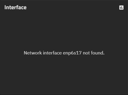

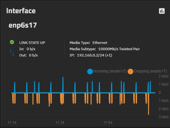

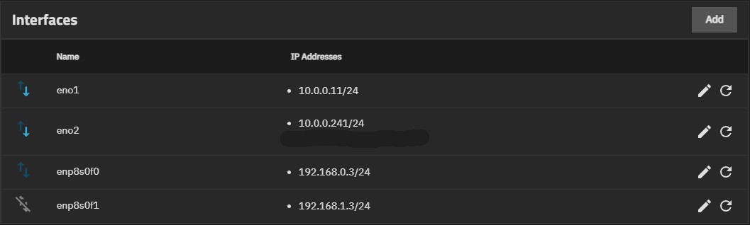

This is the status on the primary bare metal Truenas:

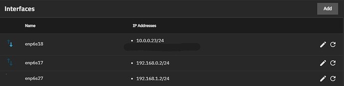

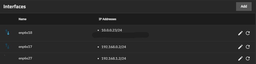

This is the status on the secondary vm Truenas:
They both show a link to each other through the cards, but Truenas 1 doesn’t see the other card settings.
They are both on the same i.p. address scheme.
Ideas?

This is strictly a peer to peer network/direct connection between 2 Truenas Machines. Both cards link up. This is got to be an internal setting with Truenas for it not to connect. They are both 10gig cards, but different manufactures. The primary 1gig to my network works fine, shares and remote, all works. Its got to be an auto negotiate setting in Truenas.
It can be a pain with direct connections.
TrueNAS doesn’t provide very good networking information and forces you to the command line for ethtool - which no doubt it then overwrites.
You mentioned one is a virtual machine. Solely for test purposes, could you use a virtio adaptor rather than the passed through NIC or simply connect the (passed through) card to your switch?
The speed can be considered once the devices are communicating.
If I were being honest, if you’re looking for close to 10GB throughput you do probably want a switch to enable flow control and duplex, let alone negotiation.
