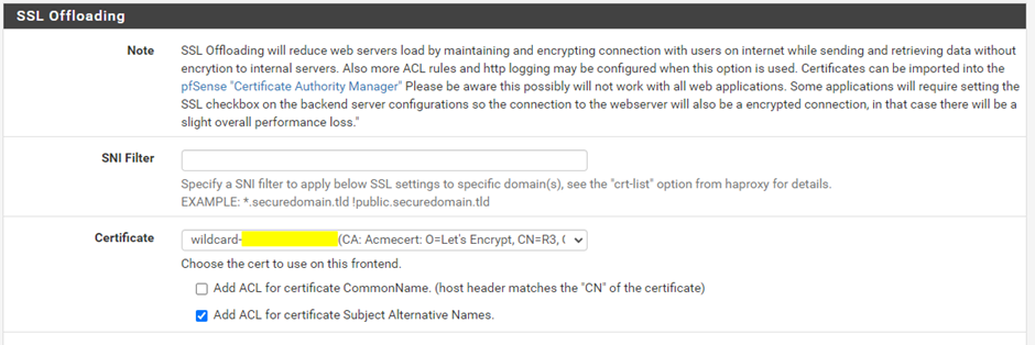

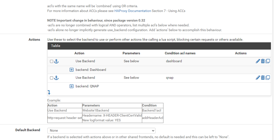

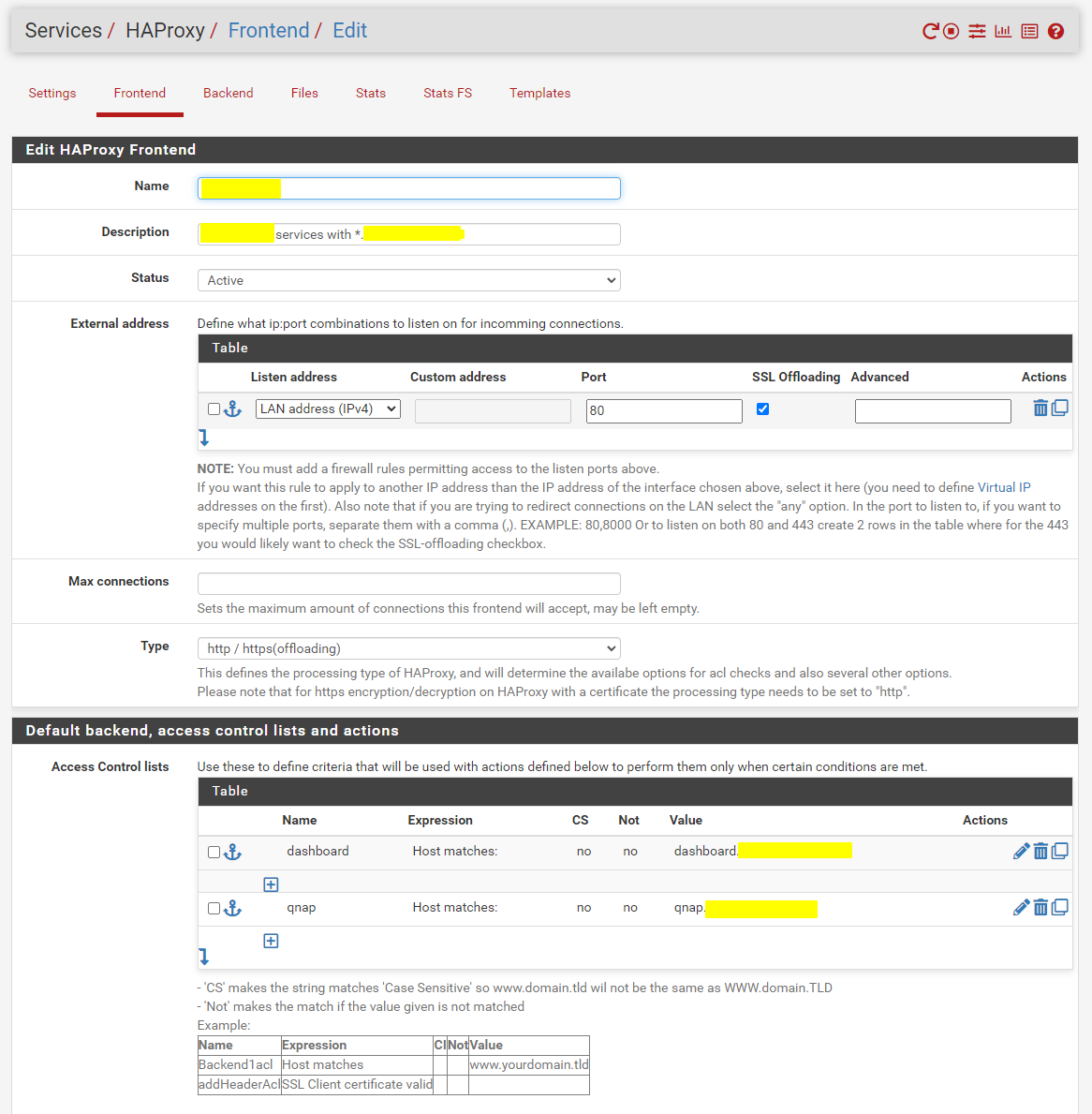

It will also help if you can post your HAProxy settings screenshot.
Front End

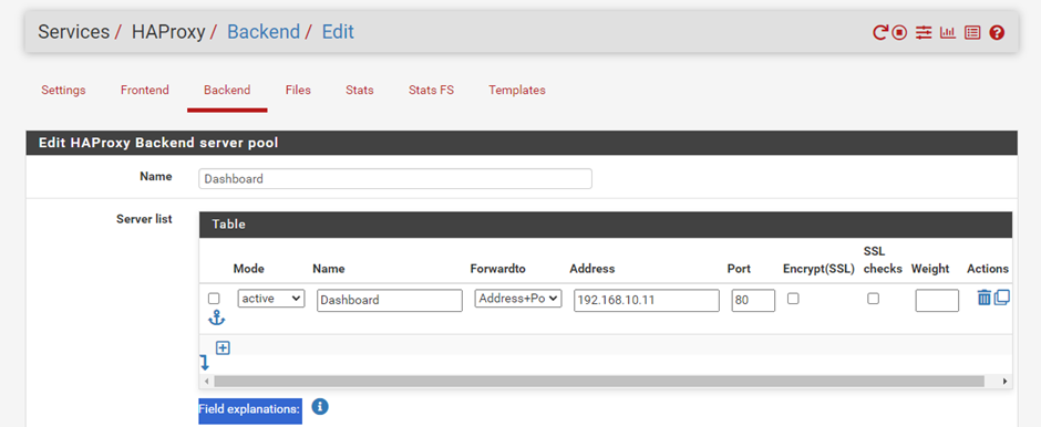

Backend

Have you tried changing port to 443 under “External address”?
I think I did. I will run through the tutorial again.
