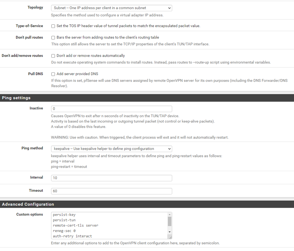

I have screenshoot my VPN client settings, and paste it here so that if you wish you can go through it, I have gone through it 3 times and I can’t find any issues.
persist-key
persist-tun
remote-cert-tls server
reneg-sec 0
auth-retry interact
dhcp-option DNS 10.0.0.241
dhcp-option DNS 10.0.0.243

For reference your configuration doesn’t look too different to mine.
However, probably where we differ are the following:
  • I use AirVPN, so I connect via an IP address and not a FQDN, I don’t totally understand how the FQDN can be resolved before the tunnel is up. Perhaps there is someway but it’s not super clear to me.
  • When I initially setup pfSense I just used the DNS Forwarder for vlans going out the ISP and the DNS Resolver for vlans going out the VPN. Perhaps there was a logic at the time, but I’ve now forgotten. For sure I had issues at the beginning which I’ve now forgotten.
I’m certain my vlans exiting via the VPN do not leak, and things work as intended, it did take me while to get there. It was several years ago so I have honestly forgotten some of the issues I had.
Perhaps if you still have the spirit left, you could try AirVPN and see if you get the same result or not.
At the time it seemed to me connecting via an IP address meant nothing needed to be resolved, perhaps, you can also change the FQDN to an IP and see if that works. At the same time it must be the case that others who are using PIA must be in the same situation as you, you’d need to ask in their forums what they do perhaps.
