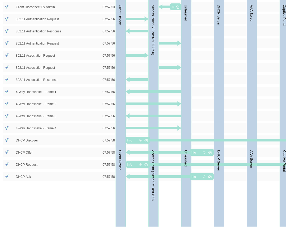

Given that all my other devices are connecting to the internet just fine I’m starting to think that there’s another setting in the Ruckus Unleashed that is causing issues. Using the Unleashed Troubleshooting it appears that everything is connecting correctly, though.
When I do I do a packet capture it appears that it is able to access the intended destination–though I am starting to get a bit over my skis when diving this far into the mix. I don’t see anything glaringly obvious.
