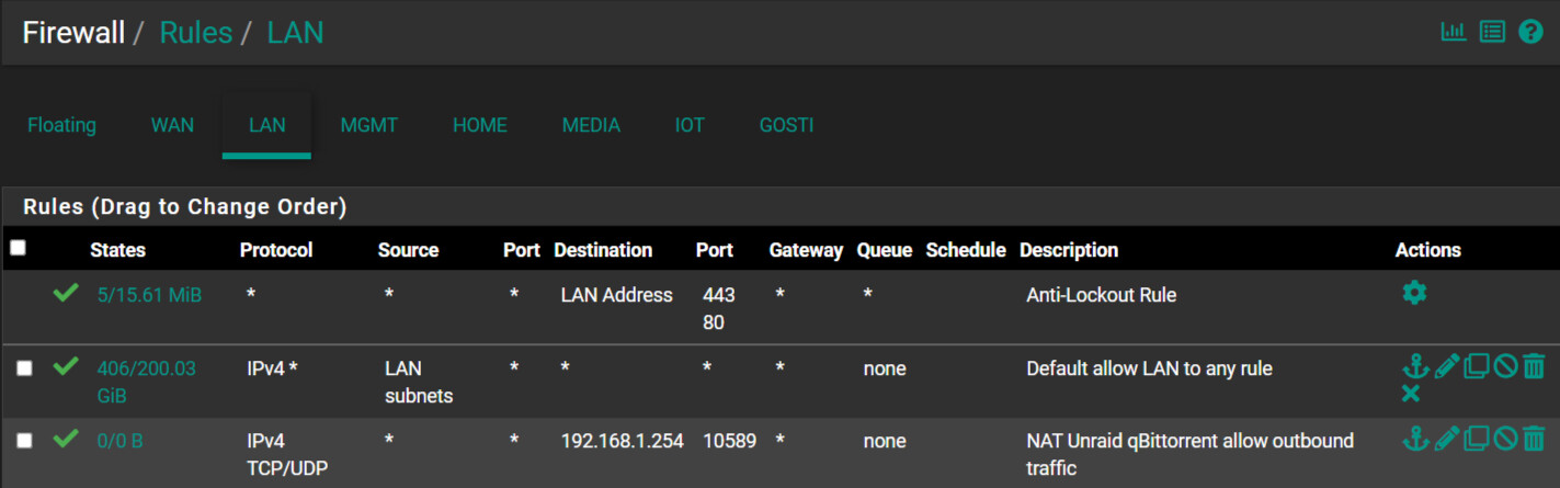

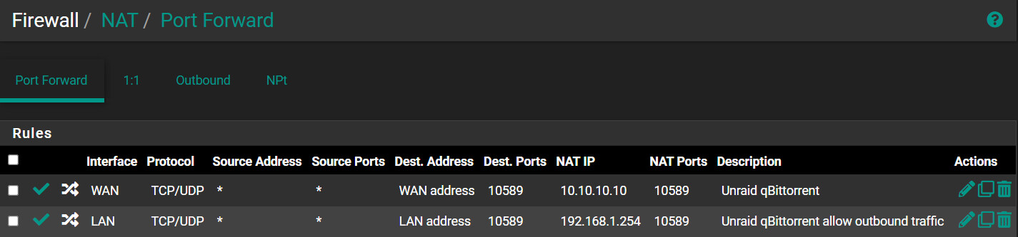

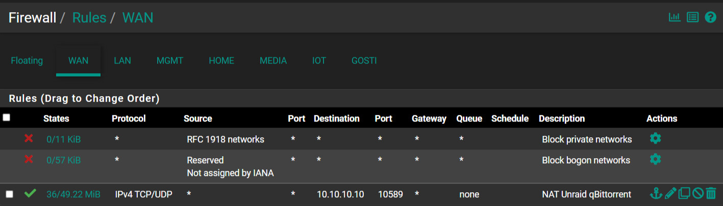

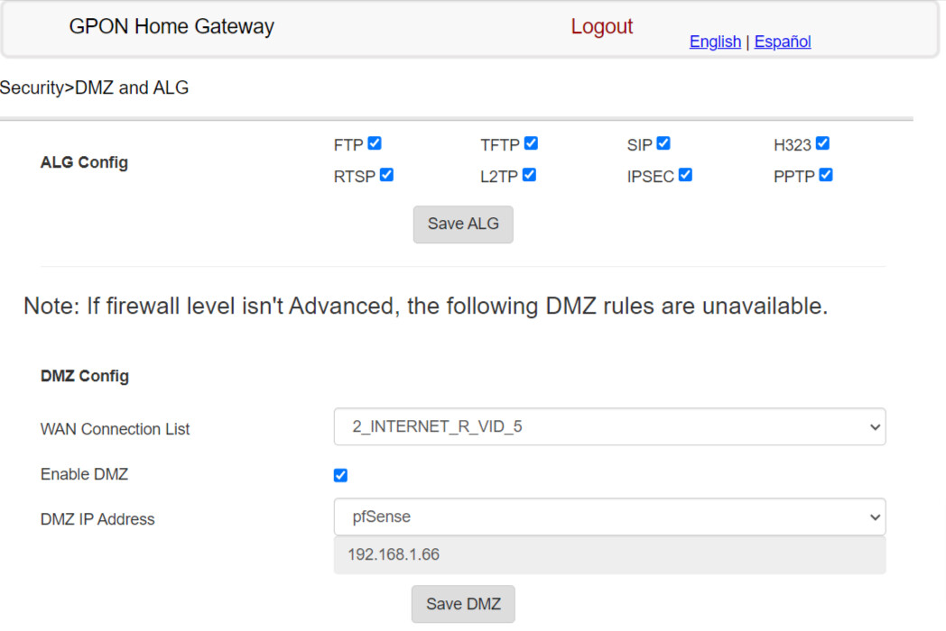

I have fixed IP address, My ISP does not allow the router to switch in bridge mode. I put the WAN address from pFsense in the DMZ.
In pfSense I opened the port in both the WAN and LAN sections. On 10.10.10.10 I have an Unraid server with qBittorrent. And at 192.168.1.254 is the address of the ISP router.
I have to mention that I’m just entering the world of pfSense and that’s why the rules are empty for me.
qBittorrent shows me: Connection status: Firewalled, and the port checking pages tell me that the port is closed.
Does anyone have any suggestions?
If you cant go into bridge mode you have a double NAT situation.
I thought that putting pfSens in the DMZ would solve it, is it worth opening the port on the ISP router as well?
