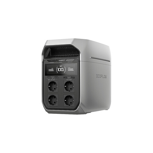

Instead of the usual Eaton or APC units, to create a more self-sufficient setup, I’m considering using a solar power station as both a UPS + primary power source.
I’d like to use something like a Delta 3 or a Bluetti.
So, in summer, I should have enough power to both run the system and charge the battery during the day, and use the battery through the night.
Then, when the battery is low and there’s not enough sun, the power would come from the main household supply.
I’ve seen that many power stations provide a pure sine wave and response times under 20ms (which is better than my old APC).
What do you think about this?
The average power consumption of the entire system is about 200W (router, switch, PoE cameras, NAS, and a couple of mini PCs running Proxmox) with max 300W at boot.
I am thinking about something like this:

I am considering the Delta 3 plus, it has a switch time less than 10ms (so very good), 24/7 and an internal battery of 1 kWh.
Here is the link:
So, with the unit alone, adding a threshold to preserve the battery (min. 20% max 80%) I should have near 3 hours.
If I add a 2 kWh battery I should theoretically :innocent: increase the battery hours to 9. Not bad.
Also during the day (especially in summer) I can power the homelab while charging the battery (2x400W panels)

I’d recommend getting 4x400w panels. This will give you some headroom in winter or on cloudy days. 400W panels will produce 400W only in ideal conditions.
My question would be do this devices have a way of communicating to the computer hardware to shutdown in the event of power issues, load battery
I use an Ecoflow Delta 2 in my home lab set up, without the solar panels, just AC mains behind it. It does not switch fast enough to be a primary UPS, I tried it. I ended up using a small UPS I had laying around. My setup goes AC mains—> Ecoflow—>UPS—> PDU.
Also these power stations are not quiet. The fans run anytime any device is drawing power, regardless if the power is coming from the AC mains or the battery. They do not drop the inverter out of the circuit, ever. Its not like a true UPS. For example, if you plug in your 200 watt load, and you are drawing power from the AC mains, the circuitry doesn’t bypass the output inverter and power doesn’t go from the mains straight to the outputs. That inverter always runs, and all of the output comes from the inverter. You can avoid this by adding an automatic transfer switch in front of the power station.
In short, its not an ideal solution. I have tried it. That being said, I paid $500 for it (so it was relatively cheap) and it will run my entire home lab for 4-5 hours in a blackout. I think you would be better off getting something designed for residential installation, and not something designed to be portable.
