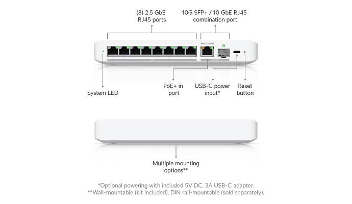

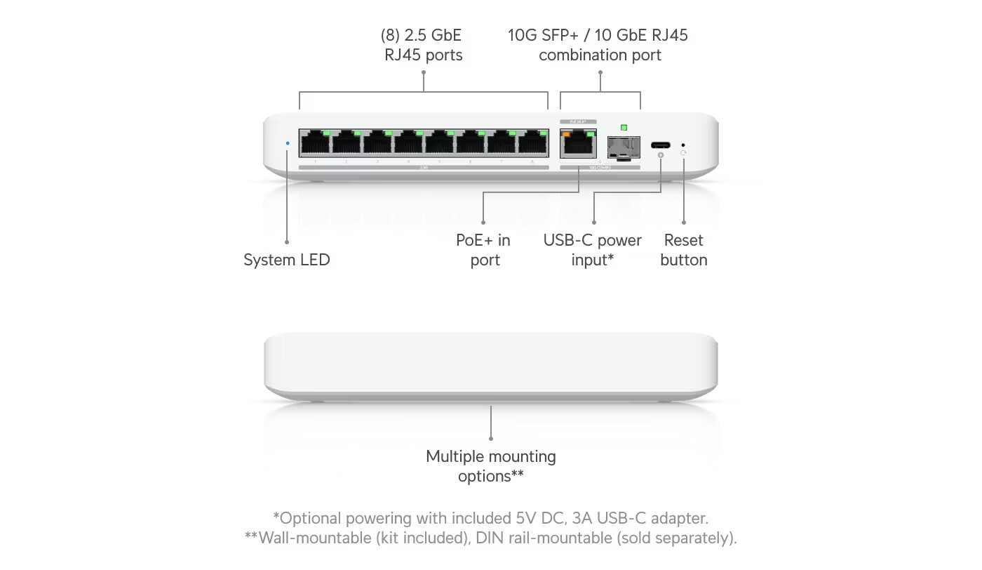

I have not used Netgear in a while but that model should be fine there are a few others here in the forum that like Netgear. Some other alternatives would be the MikroTik CRS310-8G+2S+in and if you want to get into the UniFi eco-system Flex 2.5G USD-Flex-2.5G-8
Please note that the UniFi equipment does not have a web interface on the devices but need to be controlled via their free UniFI controller software.

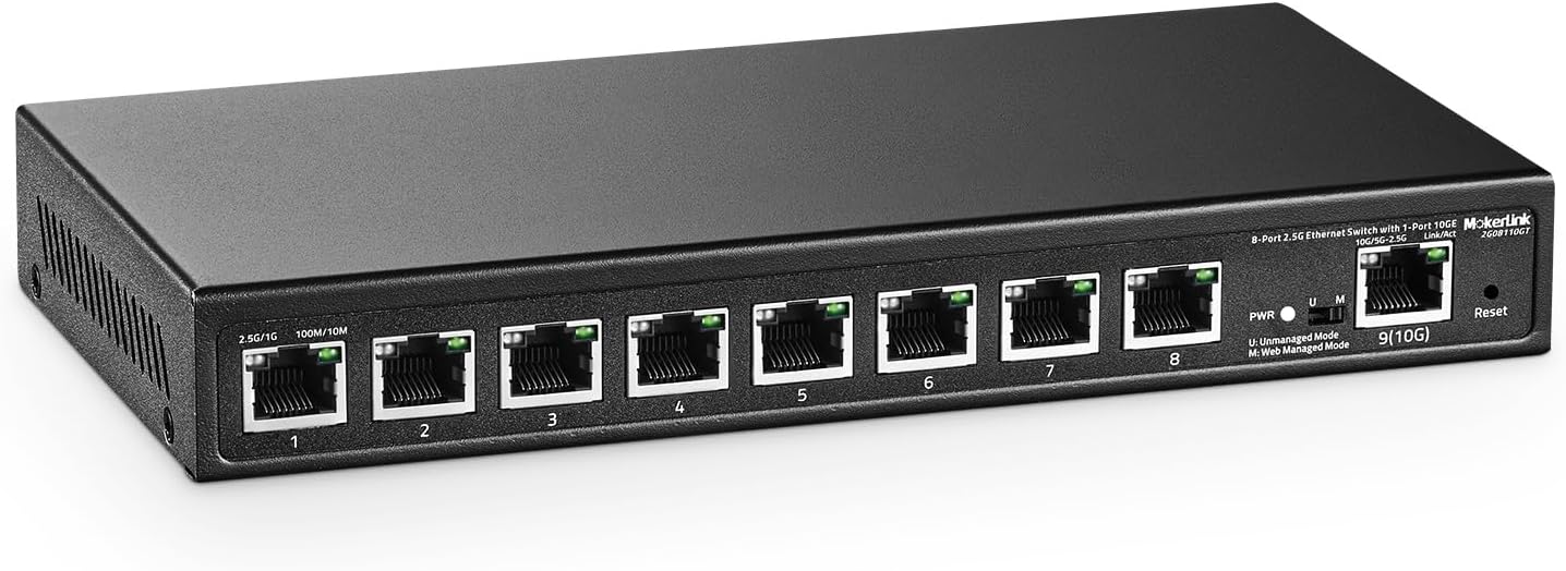

I generally avoid the managed version of those cheap Amazon/AlliExpress switches

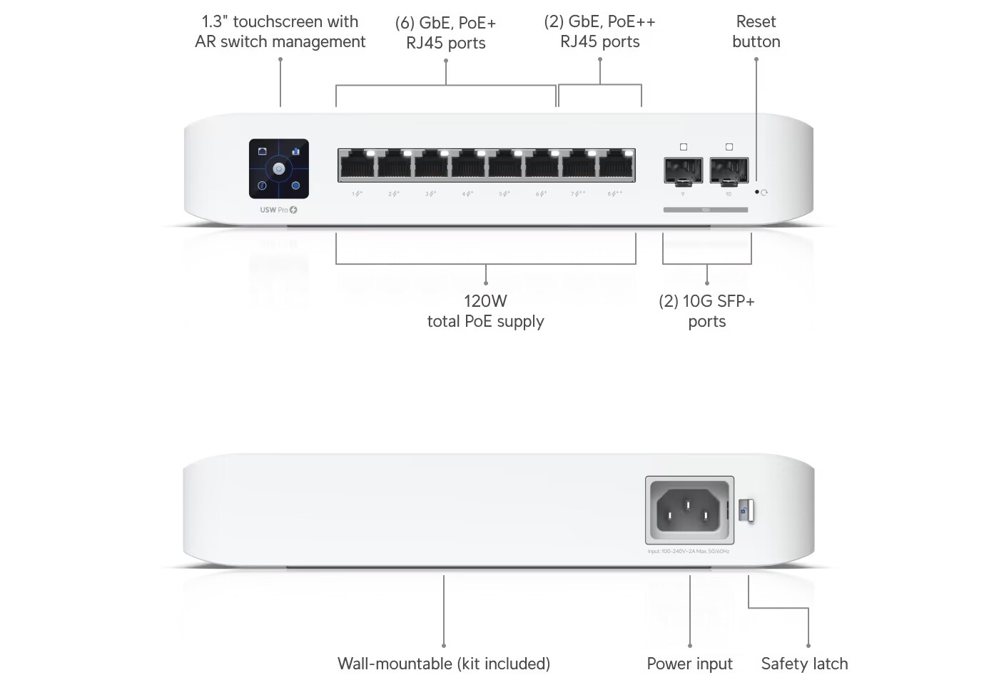

The following PoE version is one I like, supports poe+ and PoE++ output, it has a lot of features including L3 management but its double the price of the other one I suggested.
If you look on the functionality chart it will show what features it supports. It has two 10 gig SFP uplink ports. Not bad at all for a 350 dollar option.

Every person here suggested something that can be 2.5gbps on the major ports, that CRS309 just happens to have ports that can be more than that. I would guess that all suggestions that include a 10gbps port can be set down to 2.5 with the correct setting or module. There was only 1 switch shown for comparison that only had gigabit, offered as an alternative with POE+ and POE++ which can be an important consideration.

The Flex 2.5 is all 2.5, and comes in a Poe++ configuration now for slightly more, both have a 10 gigabit uplink port that does handle 1/2.5/10 speeds as far as i know. Its passive and a good deal for 199 bucks IMO.
